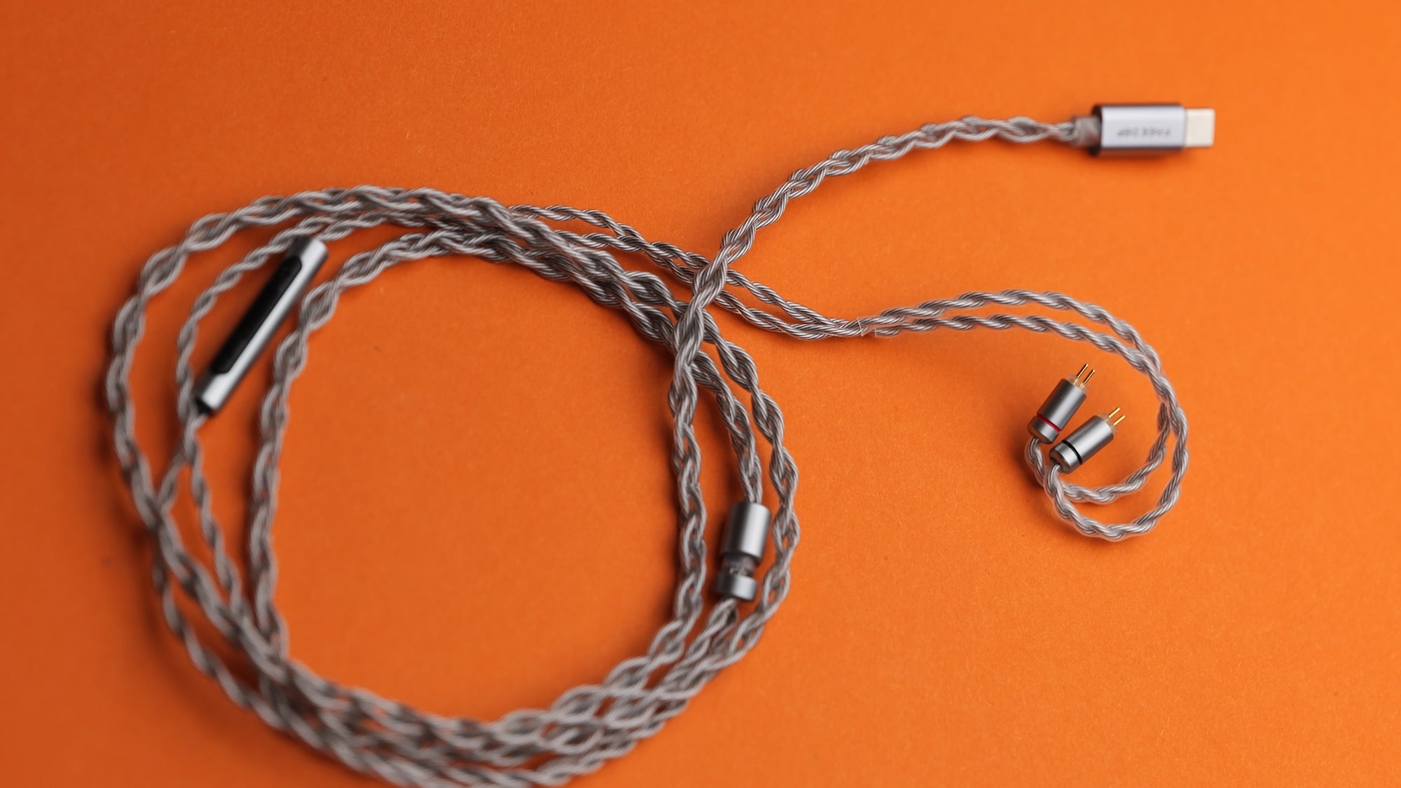

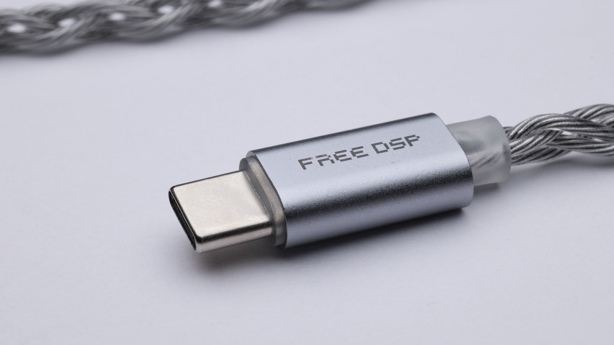

 The actual unit itself however is very nicely constructed especially considering this comes in at under $30! It features an all metal construction and excellent finishing on the USB C connector housing, 2 pin connectors, and the splitter, as well as the cable itself being soft, very flexible, with only a small amount of shape memory.
But what’s most impressive is the fact that besides the connector itself being USB C rather than 3.5mm or 4.4mm, there would be little to indicate this was anything more than a regular cable. All of the digital components are built into the USB C housing and it remains extremely compact, in fact hardly any bigger than the USB-C housing on many of the cables I have laying around anyway.

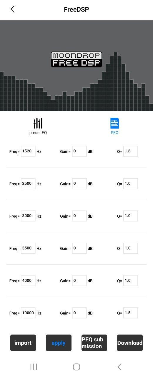

If you do choose to accept this, you will be greeted by this menu:
There is no visual display of the EQ profile you are creating, which makes it much more difficult to understand the impact on frequency response your adjustments will have. Though there are also other limitations which make creating a profile with the impact you desire rather difficult.
- All adjustments must be within 40hz-10khz. Anything outside of that range is not possible
- All adjustments must be in 1dB increments. No finer adjustments can be made
- You may only use peak filters, no other types such as shelf filters.
- Adjustments must be between -12dB and +3dB, preventing anything more than a moderate increase.
- There is no headroom/preamp functionality, meaning any positive adjustments can cause the device to clip.
These issues make creating EQ profiles very restrictive, much more so than almost any other tool, and as a result I found myself struggling to get the results I wanted, often resorting to using other tools such as Roon and its visual EQ configurator to try to find ways to alter my desired profile in a way that would still get close to the desired result, but fit within the constraints set by the Moondrop app.
The lack of a headroom function is quite severe however, as this means that even a 1dB increase on any EQ band can cause the device to clip and distort. This is not an issue if you are running the device comfortably below its max volume, as turning the volume down does provide digital headroom prior to the application of EQ, but for those that are using IEMs where they will need to be close to the max volume offered by the device, it is very likely that you will get it to clip if you are using any positive value EQ adjustments.
Whilst some of these limitations are understandable given the fact that the device is likely restricted on available processing power, the bigger issue is that none of these limitations are disclosed on the product page. You simply have to find out AFTER buying it. And for a product advertised almost solely for the purpose of providing EQ, being incredibly limited in how it can apply EQ is quite the own-goal, and in my opinion this product is simply not suitable for its intended purpose. Though regardless of suitability, these limitations should absolutely have been disclosed to the consumer BEFORE purchase.

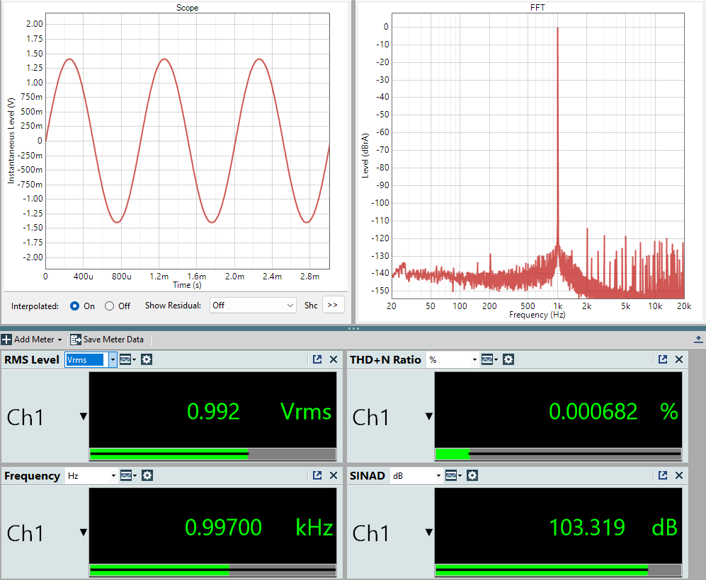

THD+N / SINAD
Disclaimer: SINAD should not be used as a figure to judge the overall performance of a product, it is a figure that combines several aspects of performance into one number whilst not including many others. It should be used as one factor among many when evaluating the overall objective performance of a device, and the type/structure of distortion can often be more important than the level of distortion/noise itself.
1khz Sine 0dBfs Output:

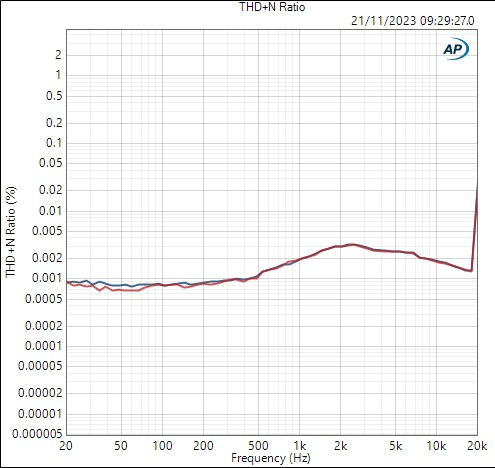

THD+N vs Frequency
THD+N has an interesting ‘hump’ centred around roughly 2500hz, though it’s not too drastic. Otherwise quite flat.

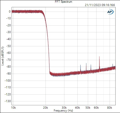

Reconstruction Filter (Nyquist/Oversampling Filter)
The oversampling/reconstruction filter fully attenuates by the Nyquist frequency which is excellent. Though it does attenuate some content under 20khz.

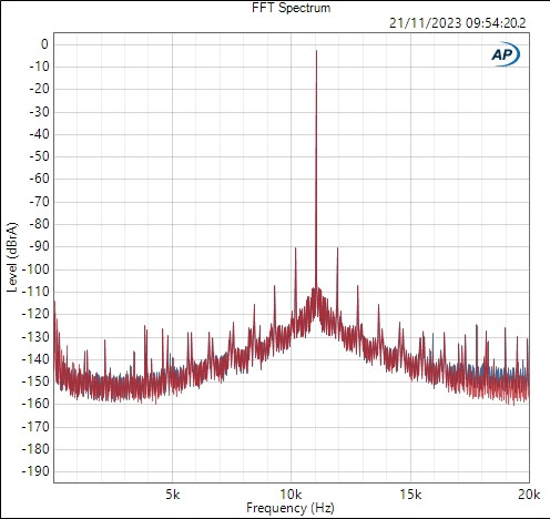

Jitter
Jitter on the FREE is quite high, with notable deterministic components and high phase noise.
I should note however that the deterministic components (spikes on the graph) were originally not present. Those showed up partway through testing and even after leaving it unplugged for a while then coming back, I could not get them to go away. The phase noise was present from the beginning, but the pattern of deterministic components suggests either a sudden hardware issue, or more likely, a side effect of some software problem, which is supported by other measurements as we will see shortly.

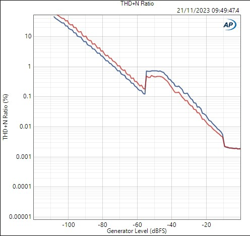

THD vs Output Level
This is quite odd behaviour. The device has consistent distortion levels for the first 10dB, followed by a sudden increase in distortion. Then at about -55dB output level, distortion performance suddenly jumps up (improves) by a fair bit. It’s not entirely unusual for devices to have a sudden change partway through their output range however. Though it IS unusual for the output level to see a sudden change relative to what it should be, as we will see next in the linearity test.

Linearity shows a sudden jump at the same spot we observed the change in distortion performance. This suggests something is causing the DACs output level to offset when crossing this point. This would presumably be a software issue. Aside from that sudden jump, linearity is quite good.

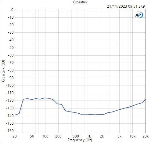

Crosstalk
Crosstalk is exceptionally good for a product of this form factor

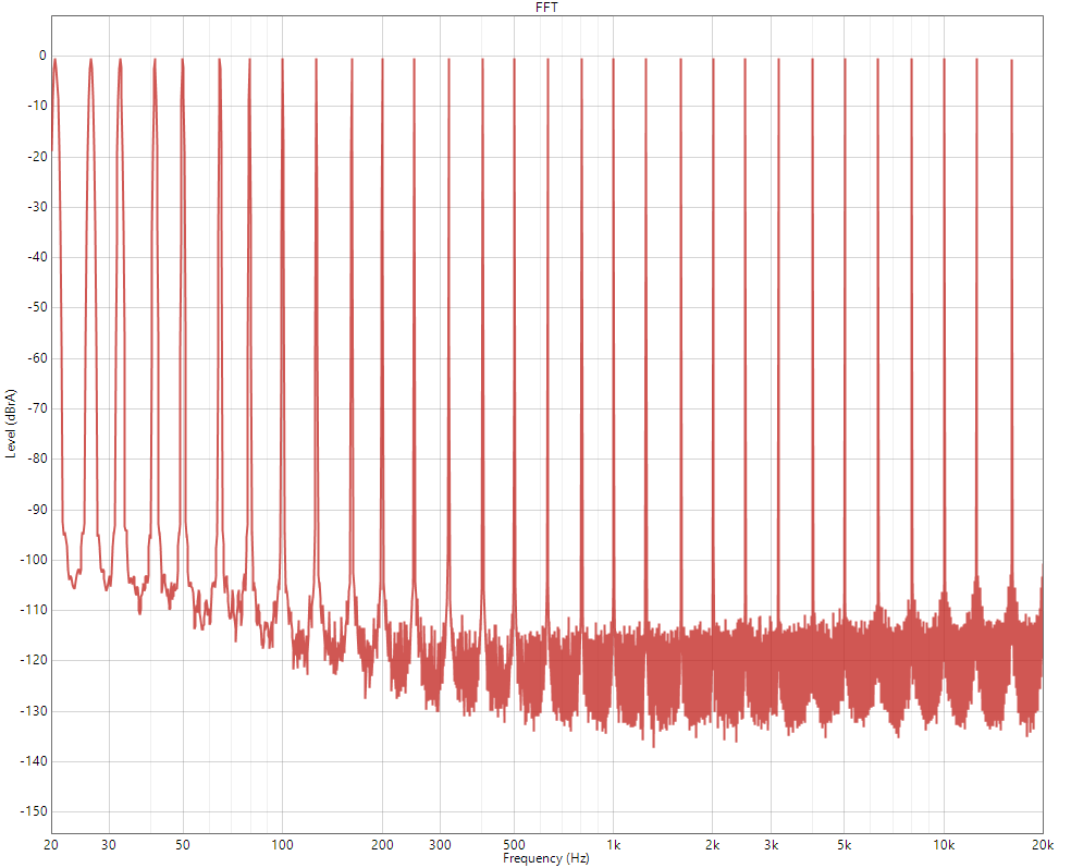

Multitone
Multitone/IMD is very clean!
