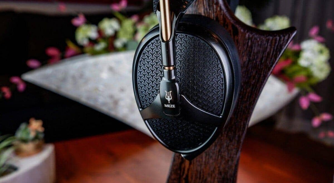

The Empyrean’s design is undoubtedly one of the most sophisticated I’ve seen on a headphone thus far. Its hand-assembled chassis beautifully blends premium materials like carbon fibre, leather, and solid aluminum; with the result being a headphone that not only looks like a sophisticated work of modern art, but is also extremely durable.
Comfort on the Empyrean is as impressive as its build and design. It comes in at 430g, but with its superb weight distribution, it sincerely feels like the lightest headphone I’ve ever worn. Then, the ear-cups’ spring-back mechanism in tandem with the plush pads make for a low clamp force listening experience. Important to note as well is that the ovoid-shaped pads are deep and very spacious, allowing the user’s ears plenty of room. Overall, the Empyrean is easily one of the most comfortable and least fatiguing headphones I’ve worn; easily on-par with the likes of the HD 800 S in this regard.
As previously mentioned, the Empyrean is the world’s first planar-magnetic headphone using an Isodynamic Hybrid Array, which uses two independently shaped voice coils on one diaphragm to handle different frequencies, and to improve acoustic delivery to the listener’s ears.
