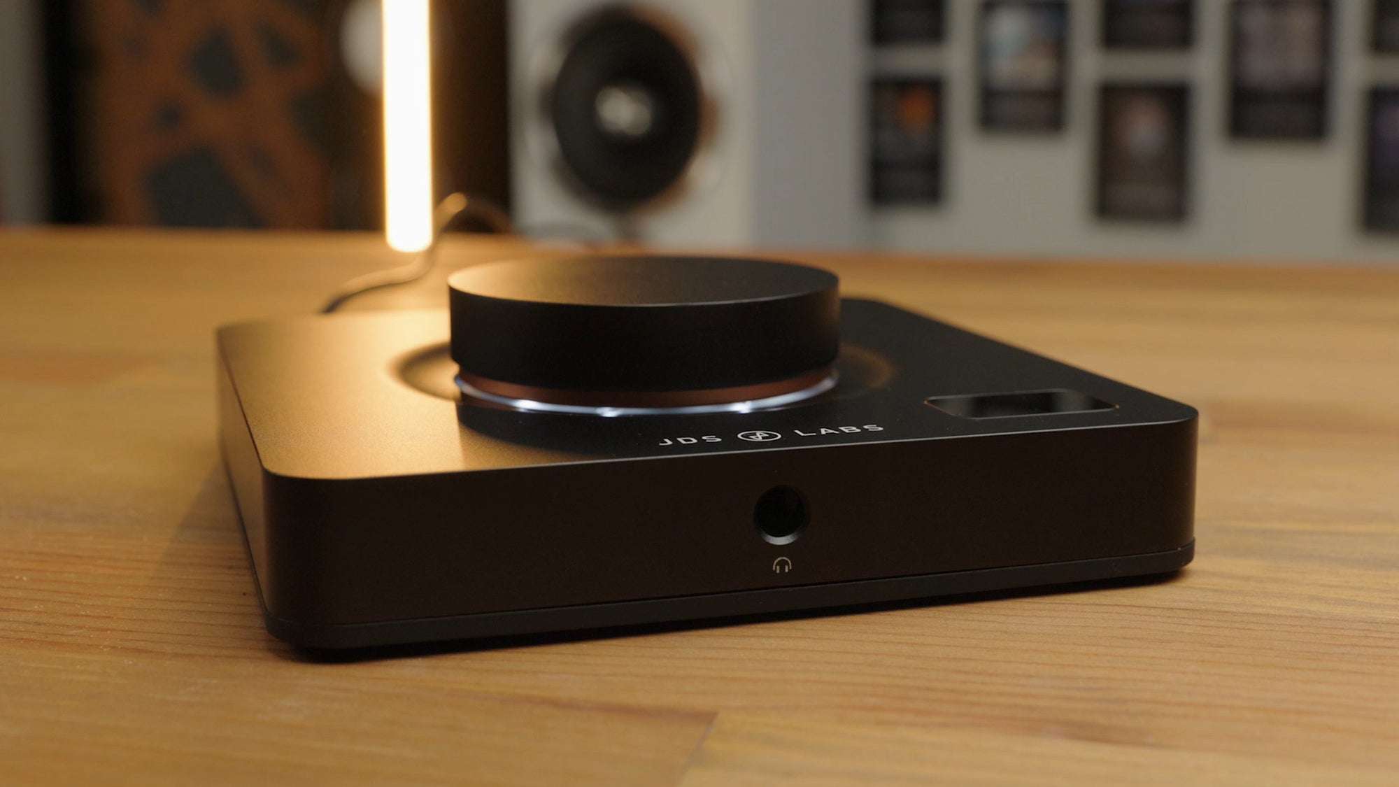

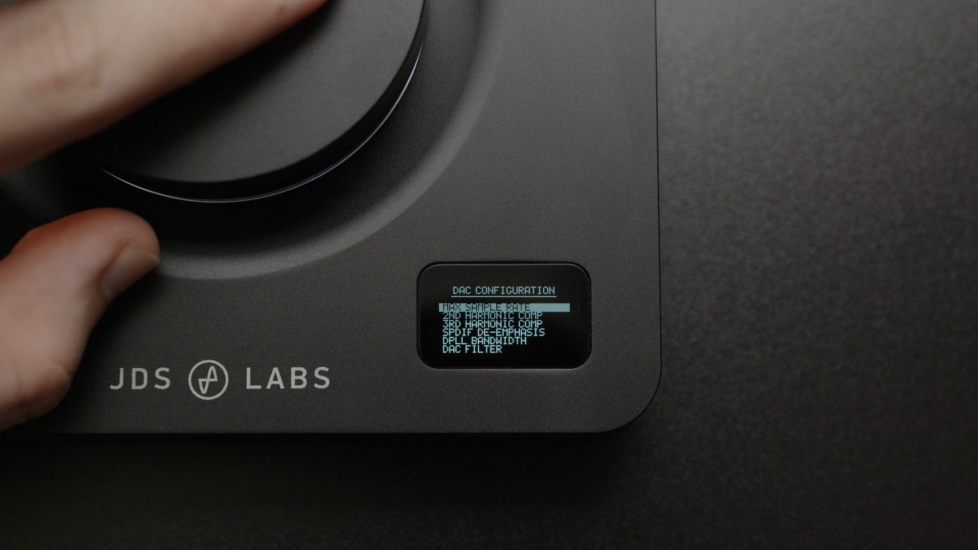

The device itself is a slim, all-metal construction that features a clean, matte-black aesthetic and one that will fit nicely into just about any desk setup. The large control knob on the top allows you to adjust both the volume control and the variety of menu options including fairly typical options such as the DAC reconstruction filter, but also some you may not have seen before such as the ESS harmonic distortion compensation parameters.
Personally I would recommend leaving the compensation settings at the defaults. I was able to very slightly improve THD by manually adjusting whilst measuring on the Audio Precision APx555B analyzer, but adjusting either option too far in either direction did make things worse. For this reason, and given as the stock settings were already incredibly close to the optimum position, they’re best left as-is. The ‘DPLL’ setting though can bring a small improvement in jitter performance when set lower. Setting this too low may mean the device can no longer lock to the input signal, and may need to be adjusted upwards again, but set this as low as you’re able to whilst still maintaining a reliable connection.

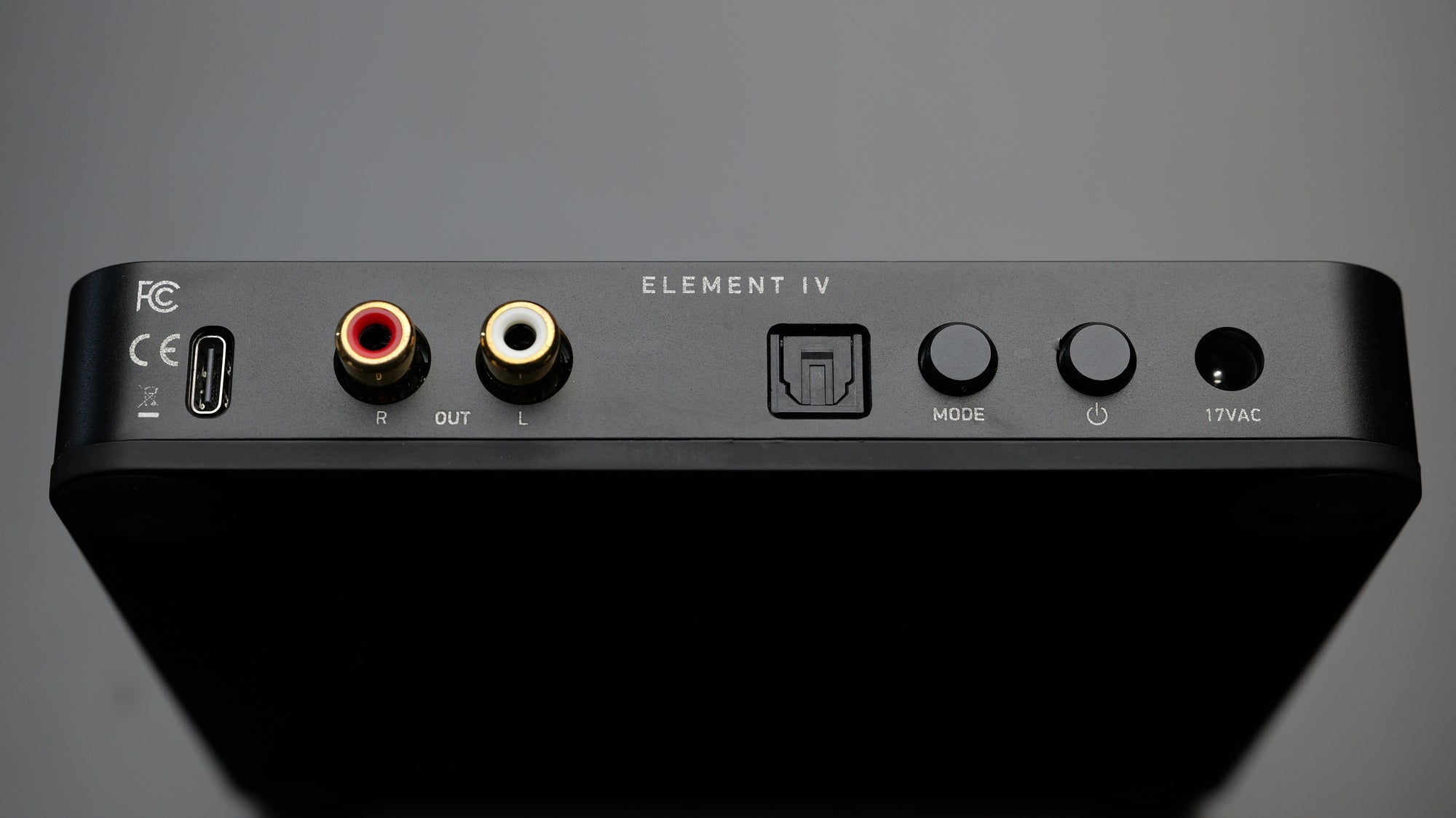

The Element IV is a DAC/Amp combo, offering USB-C and optical SPDIF inputs, as well as a pair of RCA outputs should you wish to use it as a standalone DAC with an external amplifier.
Being a single ended device, there are no XLR outputs for the DAC itself or the headphone amplifier, however JDS will upon request swap the 6.35mm output port to a 4.4mm pentaconn balanced port. Although this is purely for convenience and the device itself is single ended internally.

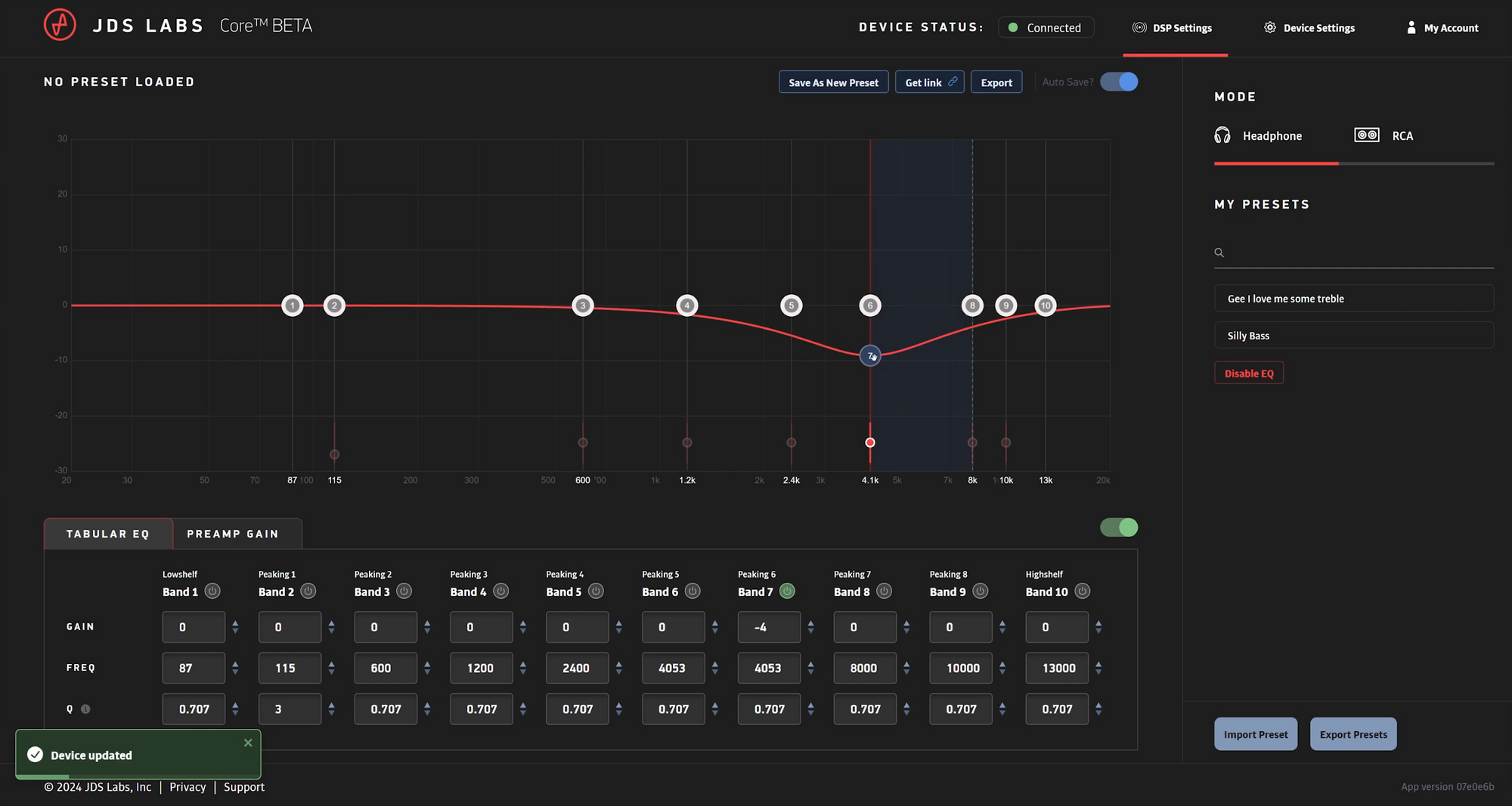

The big new feature on the Element IV is built-in EQ functionality, all of which is accessible via a web-panel.
The UI here is overall excellent, making it extremely easy not just to set up your own EQ profiles, but to import from other JDS users, squiglink or local files, and multiple profiles can be saved and swapped easily.
You can even set separate profiles for the headphone and RCA outputs!
I did find a few minor quirks with the UI as it stands currently, the most frustrating of which was that disabling an EQ band does not simply turn it off, but instead sets the gain value to ‘0’, meaning you are unable to simply turn it back on and instead have to manually adjust the gain back to where it was before. This makes AB’ing individual changes rather difficult and I hope JDS can modify this in a future software update.

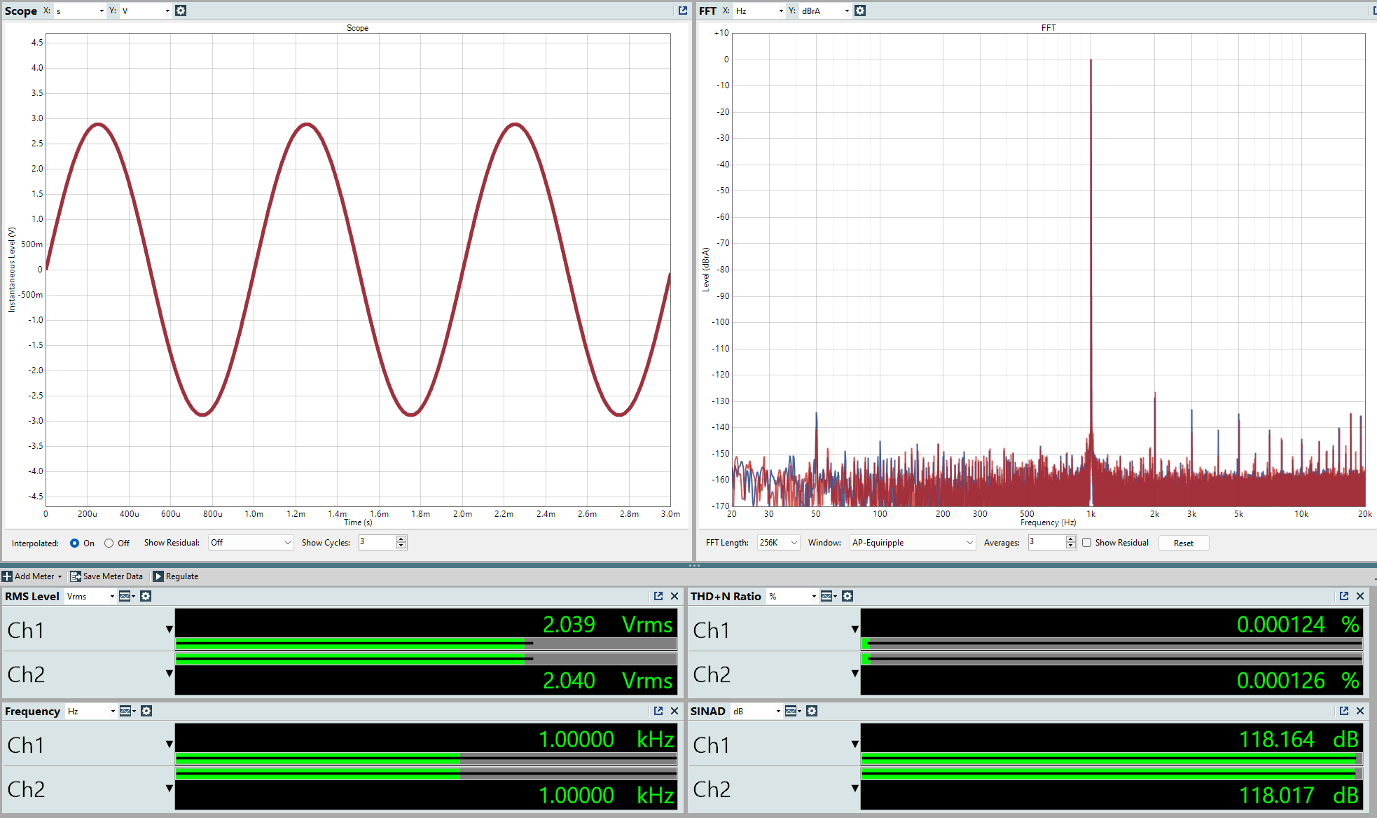

THD+N / SINAD
Disclaimer: SINAD should not be used as a figure to judge the overall performance of a product, it is a figure that combines several aspects of performance into one number whilst not including many others. It should be used as one factor among many when evaluating the overall objective performance of a device, and the type/structure of distortion can often be more important than the level of distortion/noise itself.

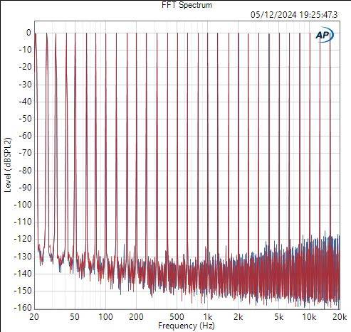

1khz 0dBfs Sine - RCA (DAC) Output:
Overall performance as a standalone DAC looks very good. Some amount of higher order distortion at very low levels, though this is fairly common on ESS designs.

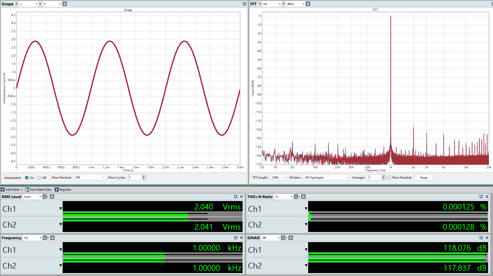

1khz 0dBfs Sine - 6.35mm (Headphone) Output - 32Ω Load:
Performance through the headphone output with a 32 Ohm load is very similar to the DAC output itself. It seems that the amplification stage itself is overall very transparent, with the main difference being a little more ‘spray’ between 50hz and about 2khz at extremely low levels. The lack of any clear change when supplying higher current means the Element IV will be well suited to driving more challenging headphones such as planar magnetic options such as the Hifiman Susvara Unveiled.
1khz 0dBfs Sine - 6.35mm (Headphone) Output - 300Ω Load:
300 Ohm performance is nearly identical to the DAC outputs themselves, again implying the amplification stage is overall extremely transparent.

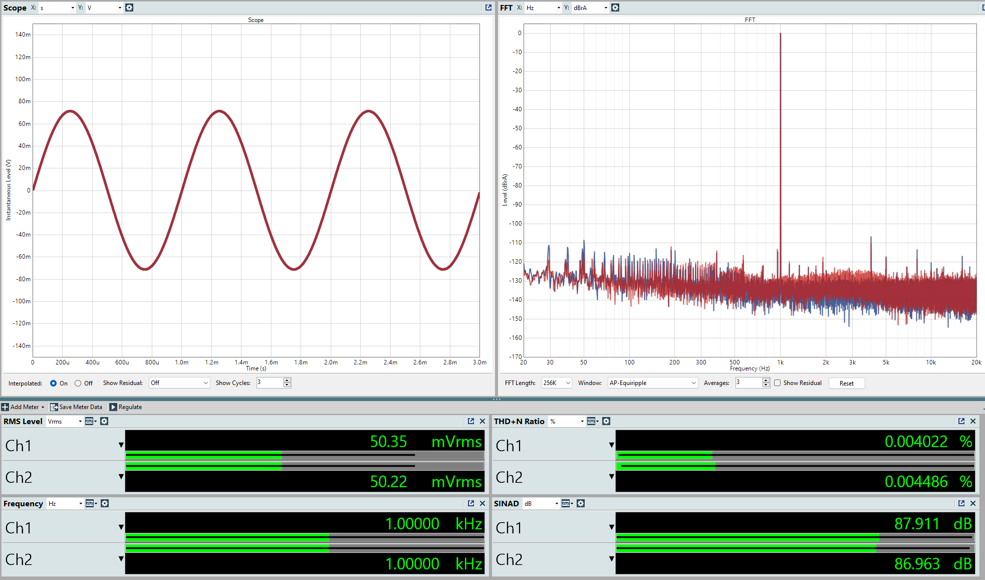

1khz 50mV Sine - 6.35mm (Headphone) Output - 12Ω Load (IEM Simulation):
At a 50mV output into a 12 Ohm load to simulate a typical IEM use case, we get 87dB of THD+N, which puts the Element IV among some of the best sources for ensuring as low a noise floor as possible with IEMs. It measures about 5dB ahead of a Chord Mojo 2, and only about 5-6dB behind the absolute best measuring devices available at any price!

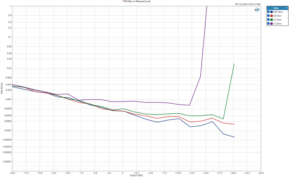

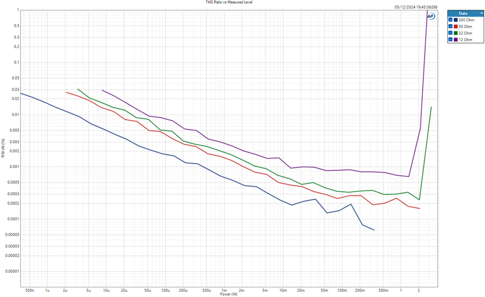

THD vs Output Level (Power)
THD vs Output level in Watts
THD vs Output level in dBV. 0dBV = 1Vrms
The JDS Element IV provides up to 3W into a 32 Ohm load, and can deliver up to 10Vrms into any load that is 32 Ohm or higher.
The gain structure of the Element IV is also done in such a way that the 32 Ohm max output point aligns with the maximum volume setting on the device, meaning unless you are using a very low impedance load, you can turn it up all the way to maximum and be certain that you are not clipping or exceeding the capabilities of the unit.

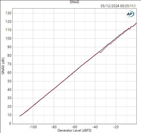

THD vs Output Level (DAC outputs)
At around -35dB there is a small change in behaviour between the left and right channels, though only to a very minor extent. Besides this, THD vs output level was extremely consistent.

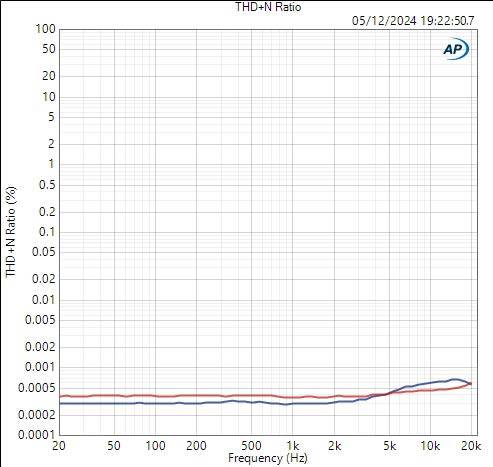

THD+N vs Frequency (96khz capture bandwidth)
(96khz bandwidth used on the analyzer. Don’t compare this directly to standalone audible band THD+N measurements as the measurement setup is not the same.)
RCA DAC Outputs
Headphone Output, 32 Ohm Load
THD+N vs frequency is completely flat at the DAC outputs. On the headphone output one channel saw a tiny increase towards the highest frequencies, but overall extremely consistent THD+N vs frequency.

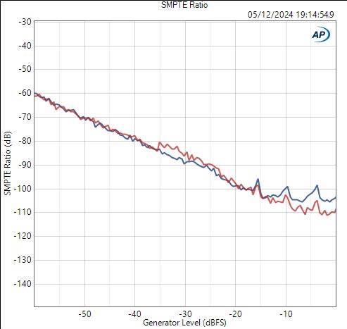

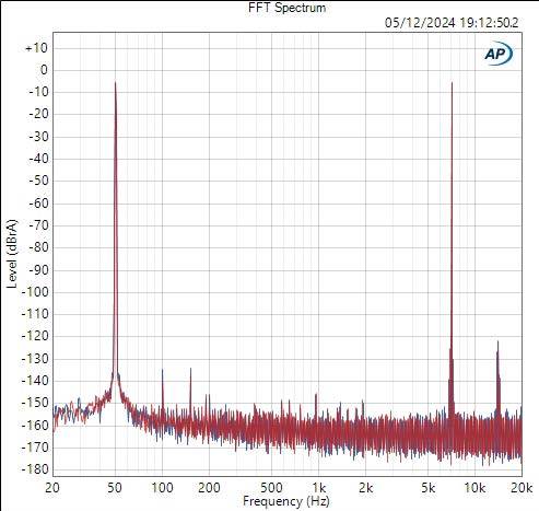

IMD vs Output Level
IMD shows a small difference in behaviour between one channel and the other similar to what was seen in the THD vs level measurement. This behaviour was the same both at the headphone output and the RCA DAC outputs so it is likely caused by the DAC itself. However the differences were minor, and overall IMD was extremely low.

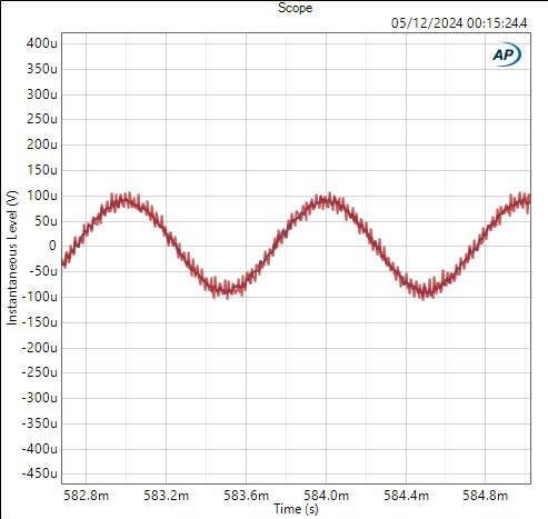

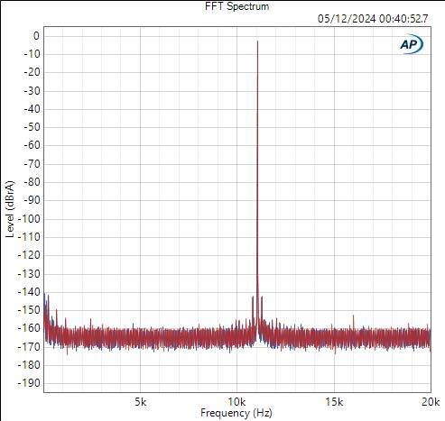

Low Level Signal Output
This test plays a very low level signal through the device to check for any unusual behaviour.
-90.31dBfs 24 bit dithered sine
-90.31dBfs 16 bit undithered sine
Nothing unusual to see here!

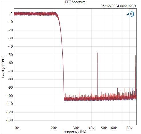

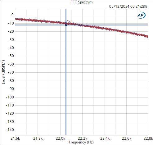

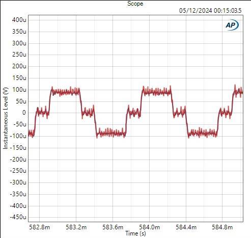

Reconstruction Filter (Nyquist/Oversampling Filter)
Fast Linear Filter
The JDS Element IV offers the standard choice of built-in ESS oversampling filter options. These were all quite standard and unfortunately none that could both keep everything under 20khz completely flat whilst also successfully attenuating fully by the Nyquist frequency of 22.05khz, though this requires more compute power to do than most products have available internally.
I would recommend using the “Fast Linear” filter if you are uncertain about which to choose.

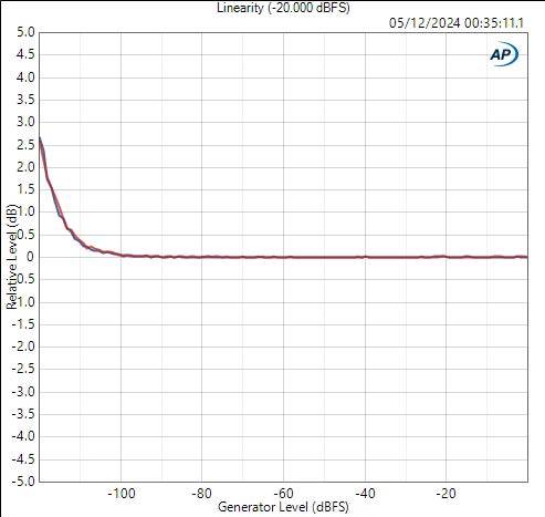

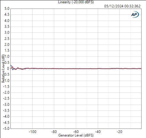

Linearity
This test plays a 1khz tone through the device, and steps down the level in small increments. Linearity measures how accurately the actual output of the device reflects the intended output. For example, if the level was stepped down by 20dB, but the output of the device was 19.7dB quieter, there is a 0.3dB nonlinearity, which would show as a 0.3dB rise on the graph.
Bandpass filtered, this is measuring only the accuracy of the 1khz tone itself
No bandpass filter, this factors in noise into the result
Thanks to the extremely low noise and distortion on the Element IV, linearity is extremely good.

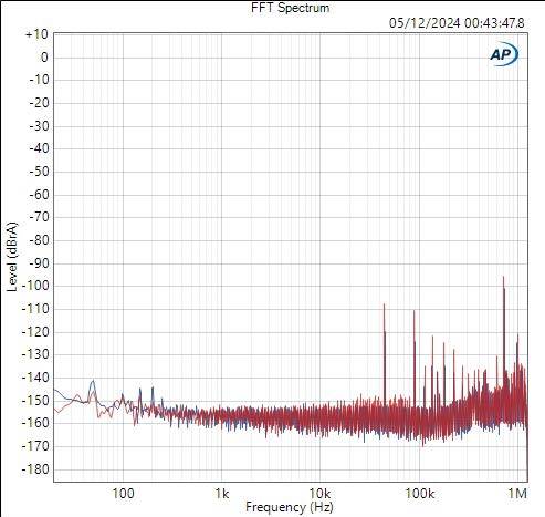

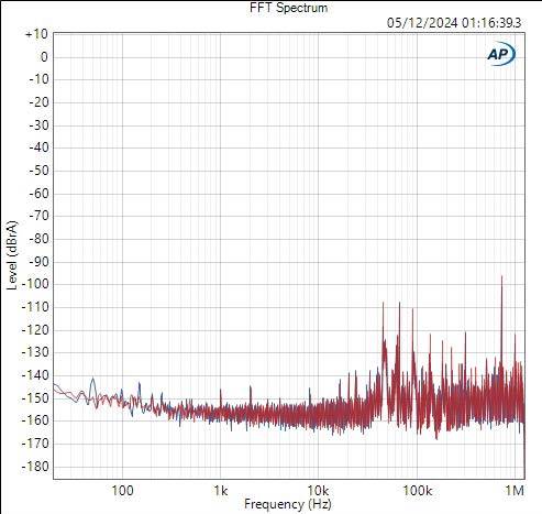

Noise
USB Isolated via JDS Synapse
USB Direct to Desktop PC
There are a small number of ultrasonic noise products visible, though all at an extremely low level, and in fact below what 16 bit resolution files would normally be able to capture.
There was a small improvement found when using the JDS Synapse USB isolator in conjunction with the Element IV, if you wish to explore the full differences between isolated and direct to a desktop PC, full reports for each both at the RCA output and the headphone output are available. Changes were generally very small, but given as the JDS synapse comes in at under $50, and measures as one of the cleanest USB sources I’ve tested, I’d recommend getting one both to ensure that the Element IV is performing to its absolute best, and because the Synapse can be used with any other DAC to completely eliminate any potential for USB source noise to cause any interference or performance degradation. Having this level of performance available at $50, rather than what would until recently have cost over $300 with an Intona isolator, is quite refreshing!

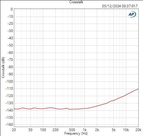

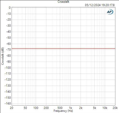

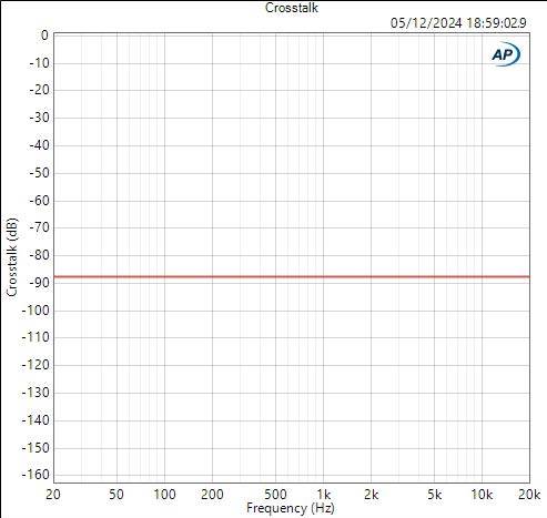

Crosstalk
Headphone Output, 300 Ohm Load
RCA Output
Crosstalk performance varied depending on the test setup. The DAC outputs themselves showed overall very low crosstalk; remaining under -130dB until 3khz and under -110dB until 20khz.
The headphone outputs showed higher levels and this would increase as current demands rose. At full scale output, crosstalk was roughly -88dB for a 300 Ohm load and -68dB for a 32 Ohm load.

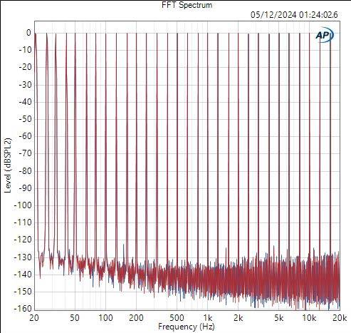

Multitone
RCA Output
No unusual behaviour observed in the multitone test, just a small rise toward 20khz as previously indicated by the THD+N vs frequency measurements. At the RCA DAC output though this rise was not present.
