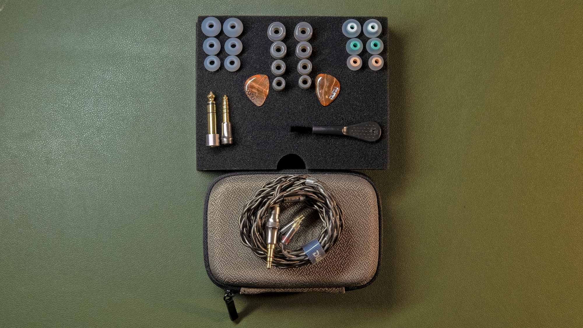

The DaVinci comes with the IEM itself, three sets of ear tips—DUNU’s own S&S tips, Candy tips, and Standard tips— and a grayish-black 2-pin modular cable that allows the user to swap between either a 3.5mm connection or a 4.4mm balanced connection. This is a nice touch! It sucks when one purchases an IEM and it comes with the wrong cable type, and it can be annoying to have to use an adapter with something you want to have a small footprint for on-the-go listening.
Touching on the ear tips, I'm definitely glad to see so many different types here. The S&S tips in particular have received acclaim in the community, and after testing them out I totally get it. They're a ”sticky” cylindrical tip that allows for a moderately deeper insert than the other tips while also ensuring a very consistent seal, at least for me. The Standard tips are an underrated option though. Even though they might be less comfortable than the S&S, I like that they are stiffer, and thus less likely to deform between seatings or users. The Candy tips I don't have much of an opinion on, as they strike me as similar to many of the generic ear tips you would find with most IEMs.

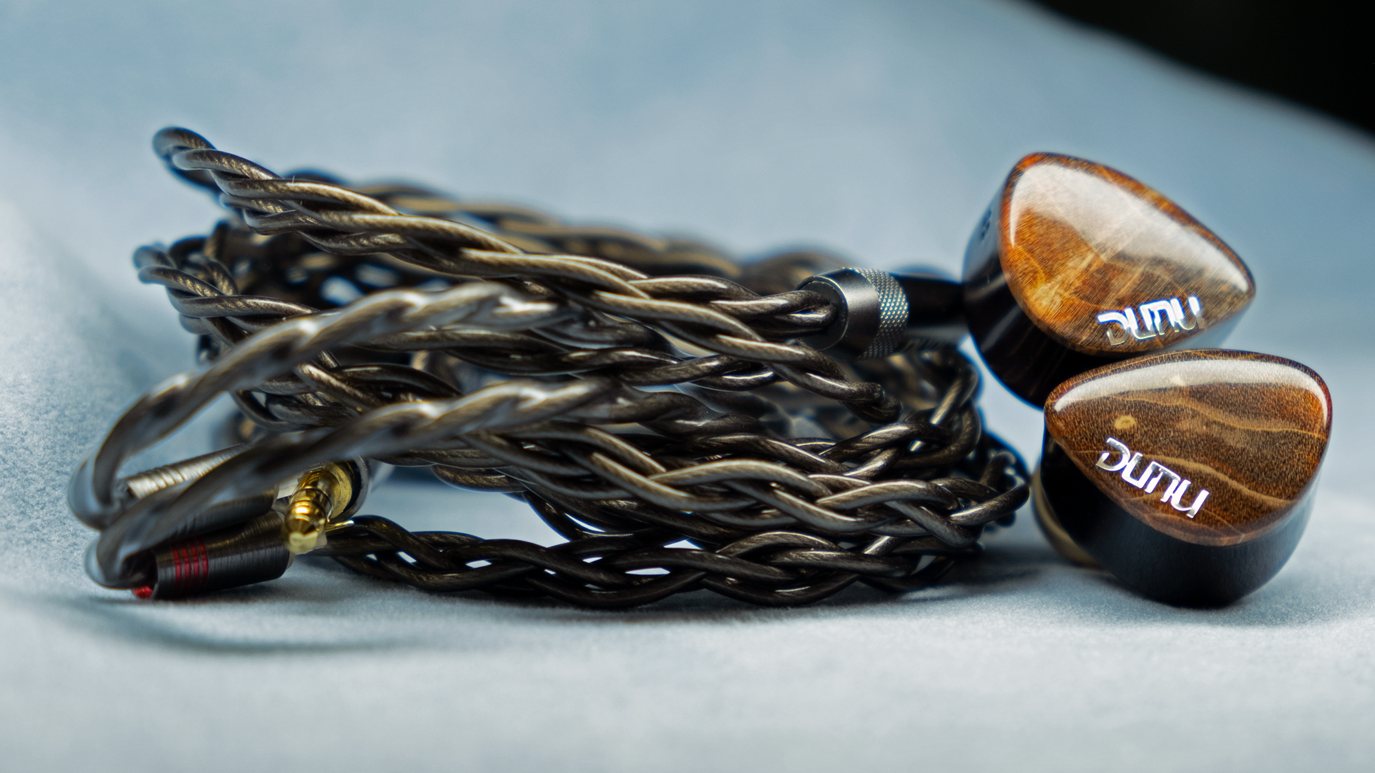

The cable is more of a mixed bag. While I have to give DUNU credit for the modular connector system, I really dislike the ergonomic profile of this cable. It’s plasticky, rather stiff, and fairly heavy. I found it a bit microphonic and annoying to use walking around the grocery store or even just on leisurely walks outdoors.
Another gripe, and more of a personal thing that I can't really dock points for, but I feel like most cables that have a chin cinch really don't need ear hooks. In fact, I would greatly prefer if basically all manufacturers stopped putting pre-formed ear hooks on their IEM cables, as it kind of forces the user into a fit profile that may or may not work for them.

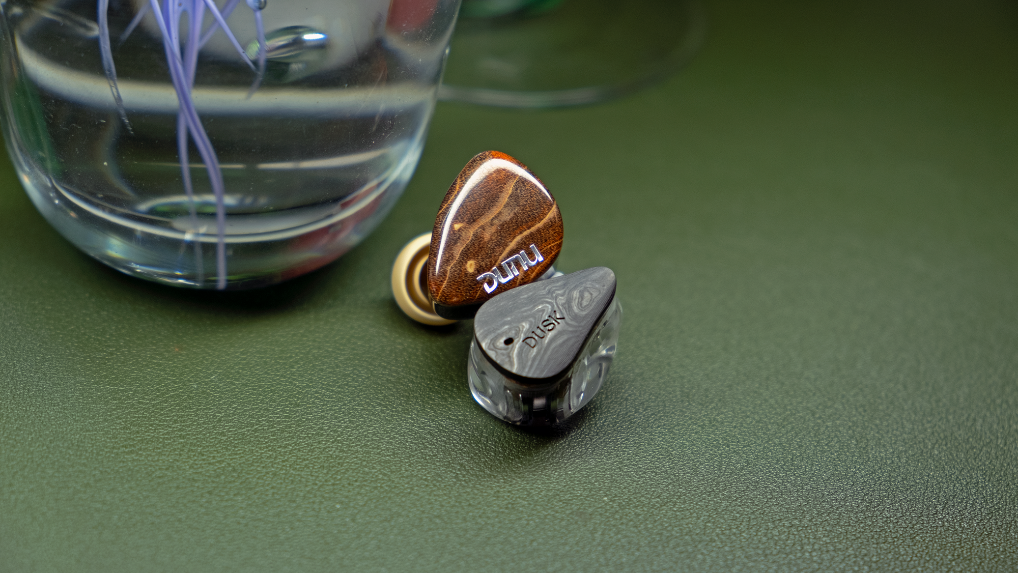

This is the comparison most readers are interested in, as the DUSK was arguably the significant example of the “new meta” released this year. In terms of tuning I do hear them roughly similar to how the above measurement looks, with a difference or two worth noting. By the way, I’m only comparing it to the sound of the Default preset, as I didn’t much care for the DUSK’s tonal profile without it.
I greatly prefer the bass response on the DUSK, as it sounds much more clean and less soft than the DaVinci. Kick drums sound bigger, heavier, and more precise in their attack. Bass synths sound monolithic and huge on DUSK while not being as obtrusively boomy as DaVinci.
However, the DUSK’s treble is meaningfully more plasticky and harsh in my ear canal, despite measuring pretty similarly on the 5128. In testing the two of them with sine sweeps, I have a potential explanation for why.
For one, my ear might just be more sensitive to ~ 9-10 kHz than 5128, which means the DUSK being “closer to the target” in that region could actually result in a boost in my ear —and I do hear it as a slight boost there on DUSK. Conversely, I hear DaVinci's slight dip here as sounding much more subjectively even.
Additionally, I think the two having different driver types in this region—planar for DUSK and balanced armature for DaVinci—means that they could be responding differently to the acoustic load of my eardrum and ear canal than that of the 5128. The DUSK’s 14 kHz peak sounds significantly higher in magnitude when compared directly to the same peak on DaVinci, and as such it needs roughly 3-4dB more reduction to sound correct in my ear vs. the DaVinci.
Getting to the actual sonic impression between them, the DUSK is more of an “all-rounder” while the DaVinci is rather firmly in the “warm, smooth, lush” camp. While the DUSK’s treble bothers me a lot more, I prefer DUSK’s snappier and more focused approach to bass. I actually prefer DaVinci’s slight extra forwardness around 2 kHz on some recordings, as it sounds a little more appropriately intense on things with a lot of overtones like electric guitar, and can sound a little less smoothed-over on things that don’t have a lot in this region like pianos.
After time with both, I think I’d end up taking the DaVinci over the DUSK for two reasons:
- DaVinci’s midrange is sometimes to my preference over DUSK, while the treble is definitely to my preference over DUSK. Keep in mind that while it is an obvious choice for me, it might be closer (or flat-out different) for others.
- DaVinci does not require a poorly-implemented DSP cable (that I cannot use with my phone) to achieve its intended sound.
The reader should also consider the issues with ergonomics I outlined earlier with the DaVinci. While DUSK certainly wasn’t a marvel of ergonomics, it was easier to spend extended periods of time with than DaVinci due to the comfort. But if I’m just going off sound, I’d consistently choose DaVinci over DUSK, and it’s almost all down to the treble response and not needing the DSP cable.
