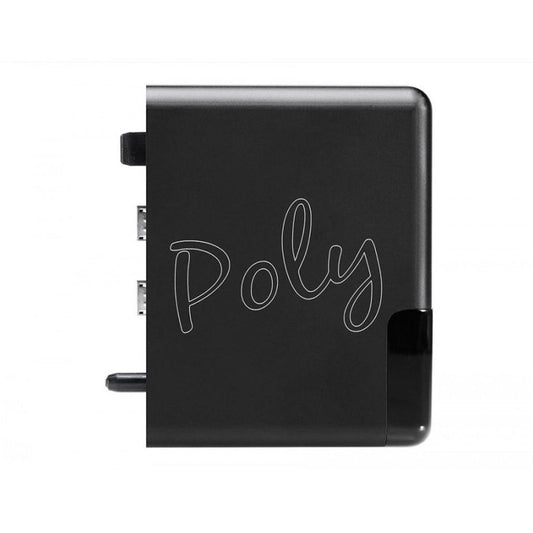

The layout has been kept similar to the original Mojo so that the Chord Poly can be used in conjunction with it.

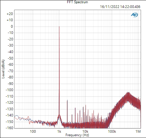

THD+N / SINAD
1khz 0dBFS Sine, 4.3V output (max level without clipping):

THD+N vs Frequency
(AES 20khz filter applied on the analyzer. Provides more relevant THD+N values at lower frequencies as noise above 20khz is ignored, but causes dips in THD+N readings at higher frequencies because harmonics above 20khz are ignored. After 10khz, all harmonics are above 20khz and are therefore ignored.)
(96khz bandwidth used on the analyzer. Provides less relevant THD+N values at lower frequencies as noise above 20khz is factored in, but shows a more accurate profile of rising distortion if present, as harmonics above 20khz are still counted.)
The mojo 2 does have some small amount of rising THD into the higher frequencies. This persists regardless of level.
Whilst from an objective standpoint, lower THD is better, from a subjective standpoint, this can contribute to a subjectively ‘sweeter’ or ‘warmer’ presentation which many people like. This is much less drastic on the Mojo 2 than some other devices, and combined with the fact that the Mojo 2’s distortion profile is almost entirely 2nd order unless outputting very high levels, and therefore more easily masked by the fundamental, it’s very unlikely to be audible.

Chord’s oversampling filter is something that they do better than any other manufacturer I am aware of currently. In the case of the Mojo 2, offering a 40,960 tap/coefficient filter. Leagues ahead of the usually 128-1024 tap filters in most modern DAC chips. This means that the Mojo 2 can fully represent all content up to the Nyquist frequency of 22.05khz, whilst having next to no unwanted ultrasonic content/imaging. This means that the Mojo 2 adheres to Nyquist theorem better than most DACs, and should be able to represent the timing of transients more accurately as a result. Research into the audibility of high performance reconstruction filters is extremely limited, and therefore audibility thresholds are up for debate. But hey, it’s always nice to see something done well, even if you may feel it’s of no audible benefit.
