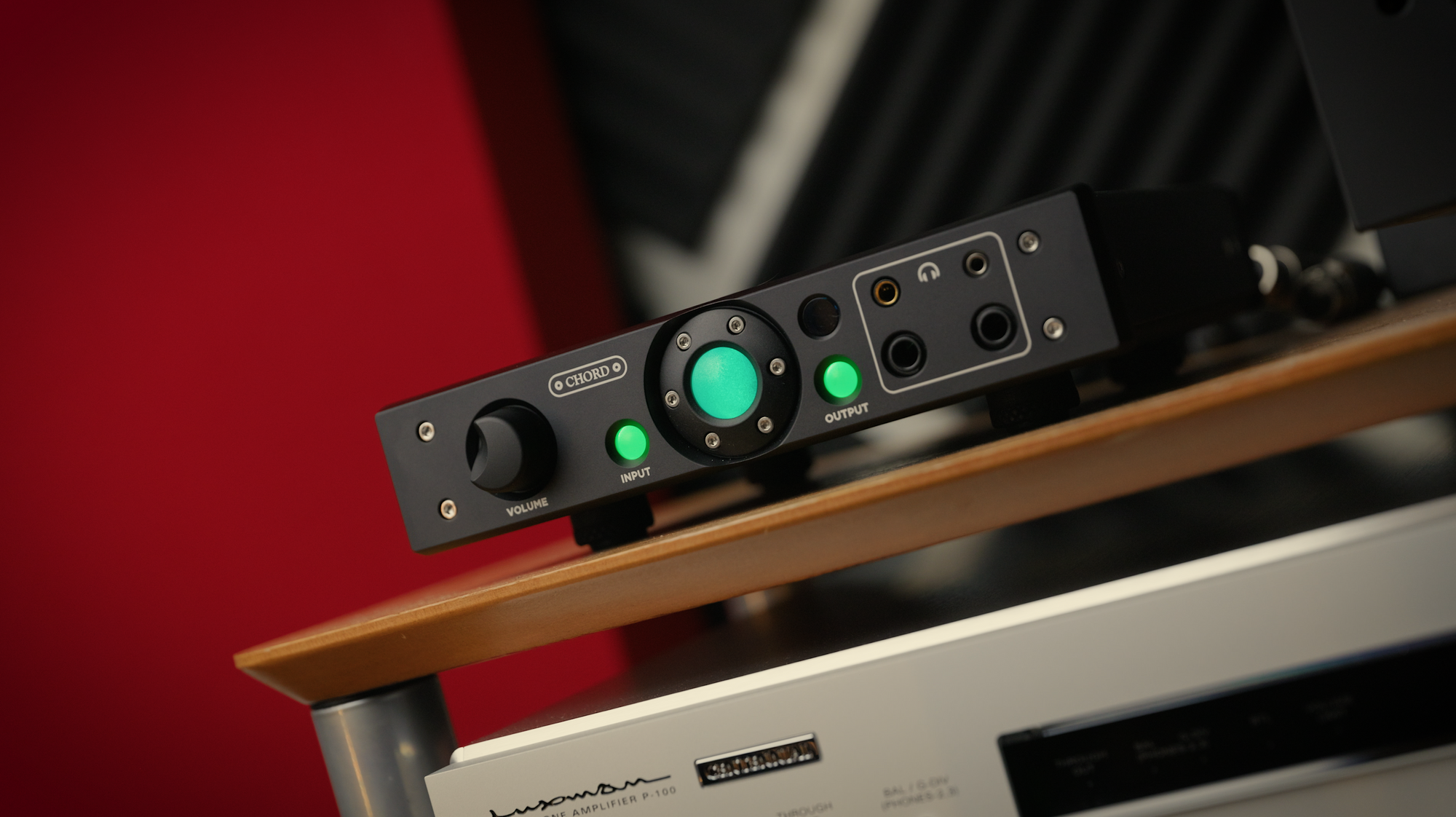

The Alto’s overall aesthetic is quite distinctly Chord, with the signature glowing glass marbles and color-coded settings, it wouldn’t look entirely out of place onboard the USS Orville!

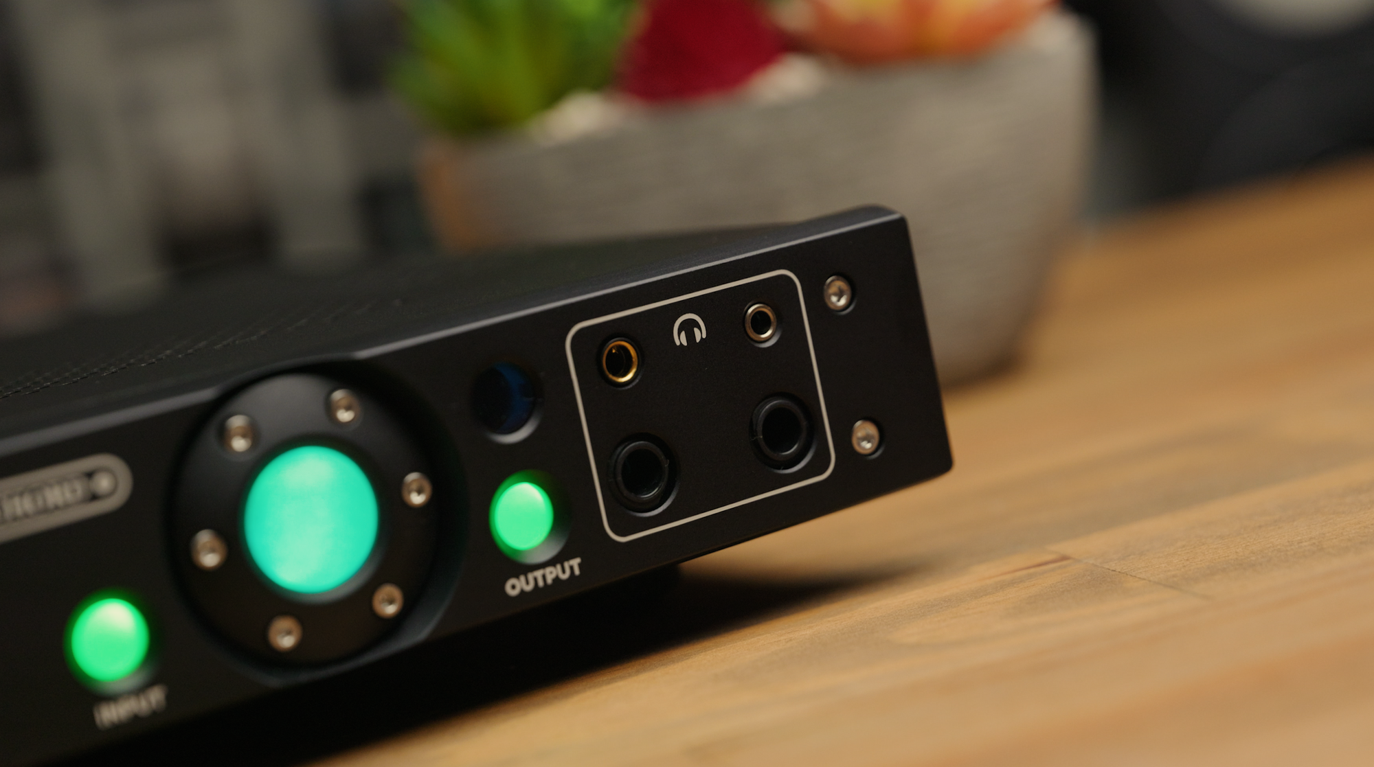

The unit offers four headphone output options, including two quarter inch jacks, one 3.5mm jack, and one 4.4mm pentaconn output although the amplifier itself is single ended so this is mostly there for compatibility.

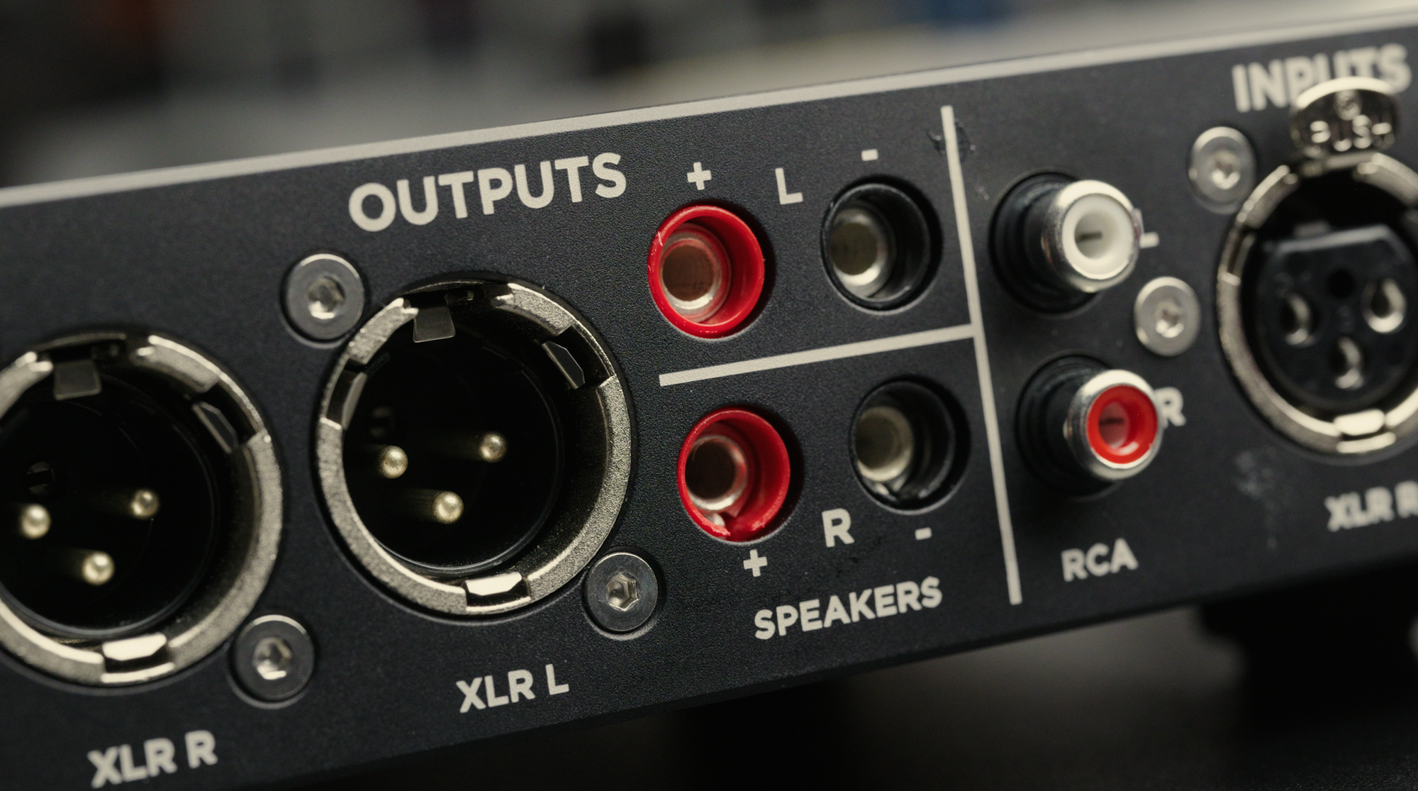

But this is not ONLY a headphone amp, it can also pump out up to 50W into 4 Ohms or 25W into 8 Ohms via the speaker outputs on the rear. Or if you are using active monitors, there are XLR line outputs that can also be set to run standalone, muted, or simultaneous output with the front headphone outputs depending on your needs.
The Alto also includes a motorised volume potentiometer, which combined with the I/O makes it quite ideal as an analog ‘hub’ for your system. Apt given as this product is primarily marketed towards the professional audio market. There is also a feature I’ve not seen on just about anything else, which is a 12V DC output on the rear, allowing you to directly power any DAC, interface, monitoring display or other product which accepts a 12V DC input, neat!

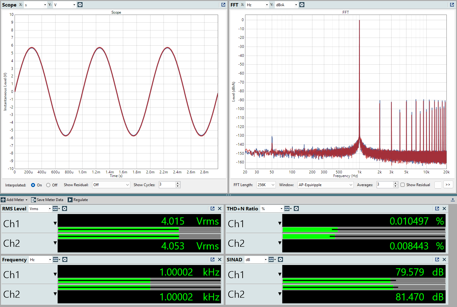

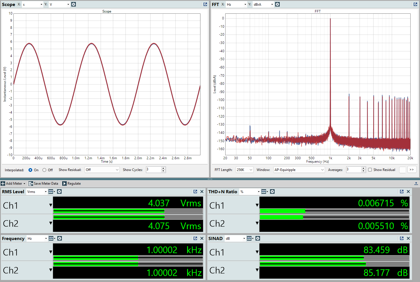

THD+N / SINAD
1khz Sine, 4V input, 4V output (300Ω Load):

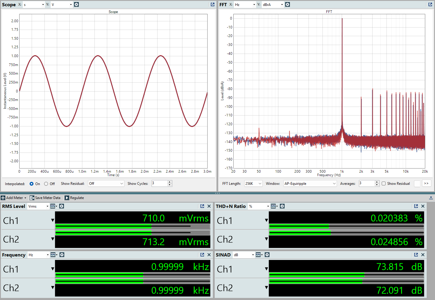

About -85dB THD+N. Definitely not as low as other options, though I think this level and in particular the profile of harmonic distortion (harmonics extending quite far, and remaining roughly equal in level), is the main reason why this amplifier has a warmer sound than options like a Ferrum OOR or Holo Bliss.
1khz Sine, 4V input, 4V output (32Ω Load):
About -80dB THD+N when the load is swapped to 32 Ohm.

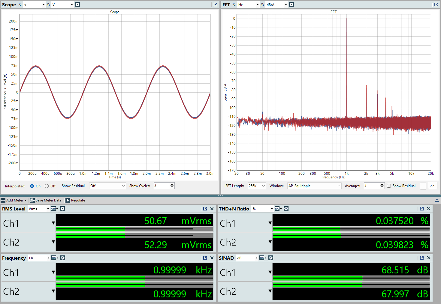

1khz Sine, 4V input, 700mV output (Headphone Level, 32Ω Load):
1khz Sine, 4V input, 50mV output (IEM Level, 12Ω Load):
With IEMs the Alto is definitely serviceable, but it may not be the best choice if you primarily use sensitive IEMs.

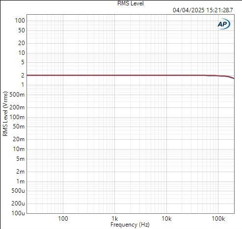

Bandwidth
The Alto has a very wide bandwidth/high-slew-rate, extending flat up towards 200khz.

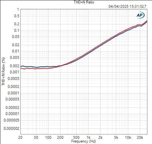

THD+N vs Frequency (96khz capture bandwidth)
(96khz bandwidth used on the analyzer. Don’t compare this directly to standalone audible band THD+N measurements as the measurement setup is not the same.)
THD vs frequency shows that bass content is significantly lower in distortion than higher frequency content. This works to the Alto’s advantage given its harmonic distortion profile. For an amp with just 2nd order only harmonics it wouldn’t matter too much if THD was high and flat vs frequency since higher amplitude bass content at 50hz is only going to be adding harmonics to the bass region itself. (The 2nd harmonic of 50hz is 100hz.) But for the Alto, where it has harmonics extending quite far, the 15th harmonic for example of 50hz is 750hz, and therefore if the Alto was flatter here or higher in THD in the bass region, harmonics from high amplitude bass content could audibly interfere with midrange content. Therefore the fact that bass content plays very cleanly means higher frequency elements are not disturbed or masked by it, and then the extra harmonics added to higher frequency content allows the Alto to ‘sweeten things up’ a bit subjectively.

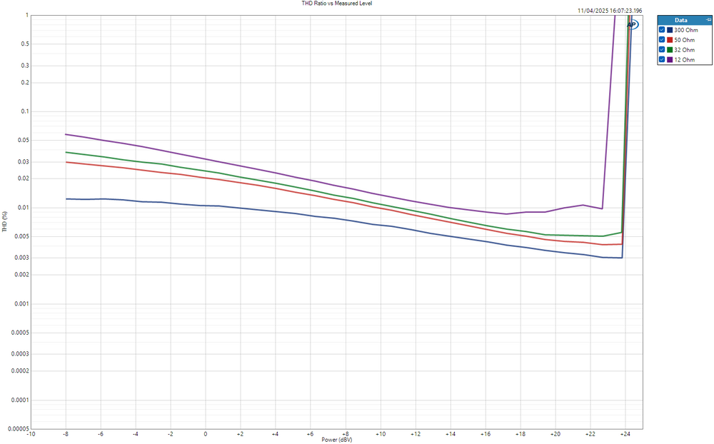

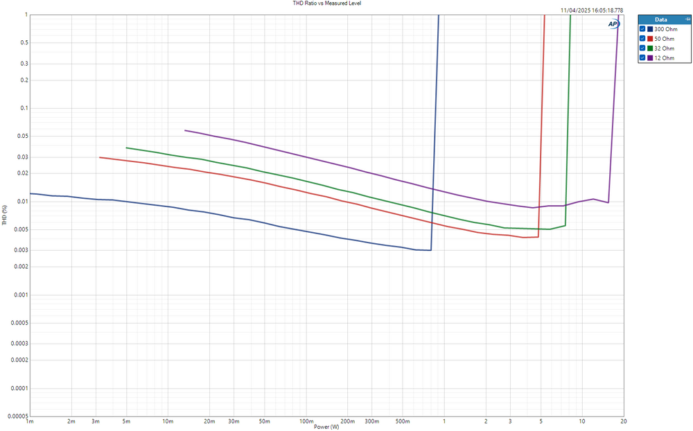

Power
THD vs Output Level in Watts
THD vs Output Level in dBv, 0dBv=1V
The Alto is quite a powerful amplifier, and as well as being able to deliver over 7W into a 32 Ohm load, it doesn’t seem to show any rising distortion as output level increases, which means the sound you get from this amplifier will be quite consistent regardless of volume or how demanding the track gets. There is some amount of flat increase in THD as the load impedance goes down however, so you may get slightly different results running much lower impedance headphones on this vs higher impedance ones.

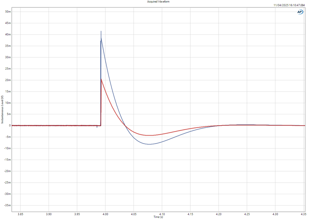

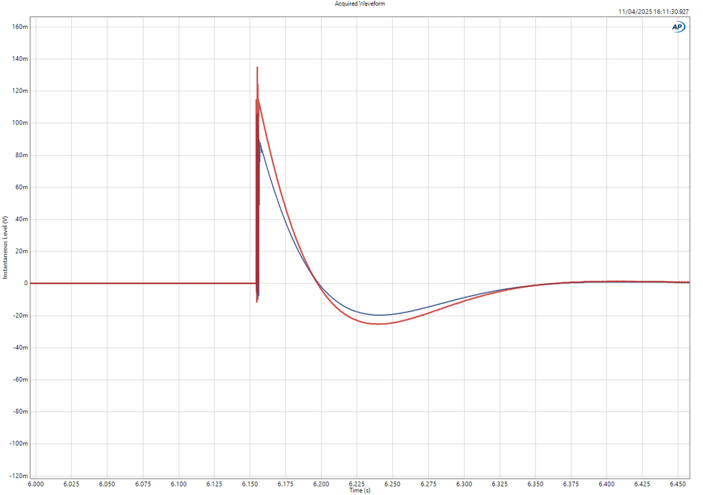

Power On/Off Behaviour
This test shows the output of the device when turned on/off, to check whether the output may put connected headphones at risk. Regardless of what this test may show, please ALWAYS disconnect your headphones when turning any amplifier on/off unless the manufacturer explicitly instructs you to do otherwise.
Turning on (from cold, 300Ω load):
Turning off (from warm, 300Ω load):
There is a moderate spike of up to about 120mV when turning the amplifier on/off. This is not close to enough to damage anything, but if using more sensitive headphones you may wish to have them disconnected or at least off your head when power cycling the unit.

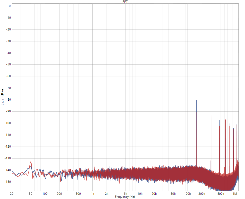

Noise
1M FFT, 3 Averages
A little bit of what looks to be switching noise visible at higher frequencies, though very low in level. Inherent noise from the amplifier is otherwise quite low.

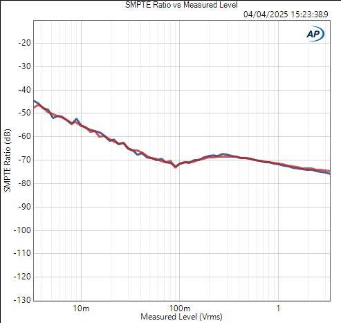

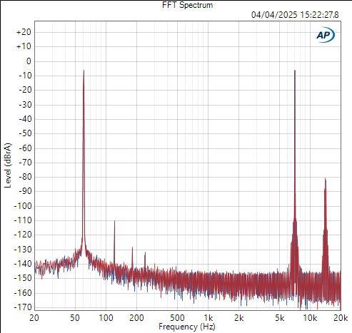

IMD
An interesting profile of IMD vs level here. Reasonably low overall.

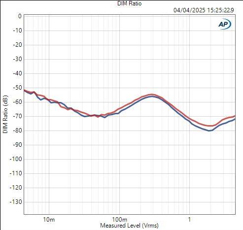

Dynamic IMD (DIM)
DIM vs level shows a pretty unusual result with a clear ‘hump’ midway through the output. This would imply that the distortion for high frequencies in particular may vary with level in a different manner to distortion for low frequencies.

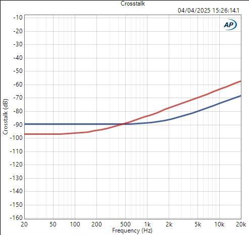

Crosstalk
Crosstalk is higher than ideal, though with this much power in this small a form factor that is often somewhat unavoidable.

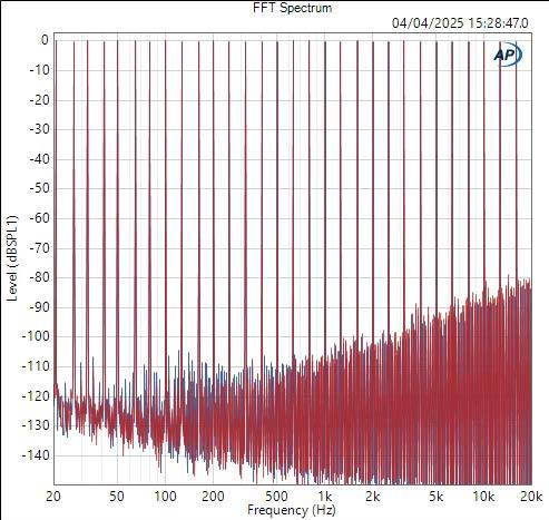

Multitone
The multitone FFT simply shows us what we saw from the THD vs frequency test. Distortion is lower the lower in frequency you go.

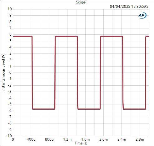

Square Wave Output
Thanks to the extremely wide bandwidth, square wave output is extremely clean.
