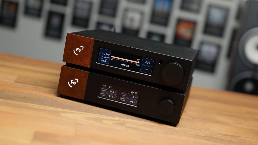

The WANDLA retains the same form factor as Ferrum’s OOR, ERCO, and HYPSOS units, meaning users with multiple products in the lineup can make quite a neat-looking stack indeed. With how compact each of these units are, you shouldn’t have much trouble finding space for them on your desk.
One concern held by owners of the OOR and HYPSOS was whether they would be able to power the WANDLA as well as their OOR from the single HYPSOS power supply, or if they’d need to make a choice between the two. Luckily Ferrum has also released a splitter unit which will allow the HYPSOS to power both an OOR and a WANDLA simultaneously.
The chassis is the same matte black finish as the other Ferrum products, accented by the corten steel square and illuminated Ferrum logo, however the display is significantly larger than that of the HYPSOS and functions as a touch screen. This is to facilitate the wealth of features and configuration options the WANDLA has to offer. There is also a metal remote included so that you can control volume and other controls from the comfort of your listening position.

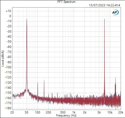

- Dynamic Intermodulation Distortion (DIM)

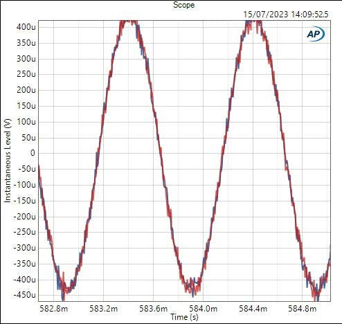

Low Level Signal Output
This test plays a very low level signal through the device to check for any unusual behaviour.
-90.31dBfs 24 bit dithered sine
Low signal levels are very clean. Slightly higher noise levels than some of the lowest noise DACs available, but only by a few dB.

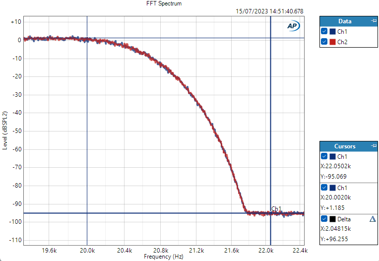

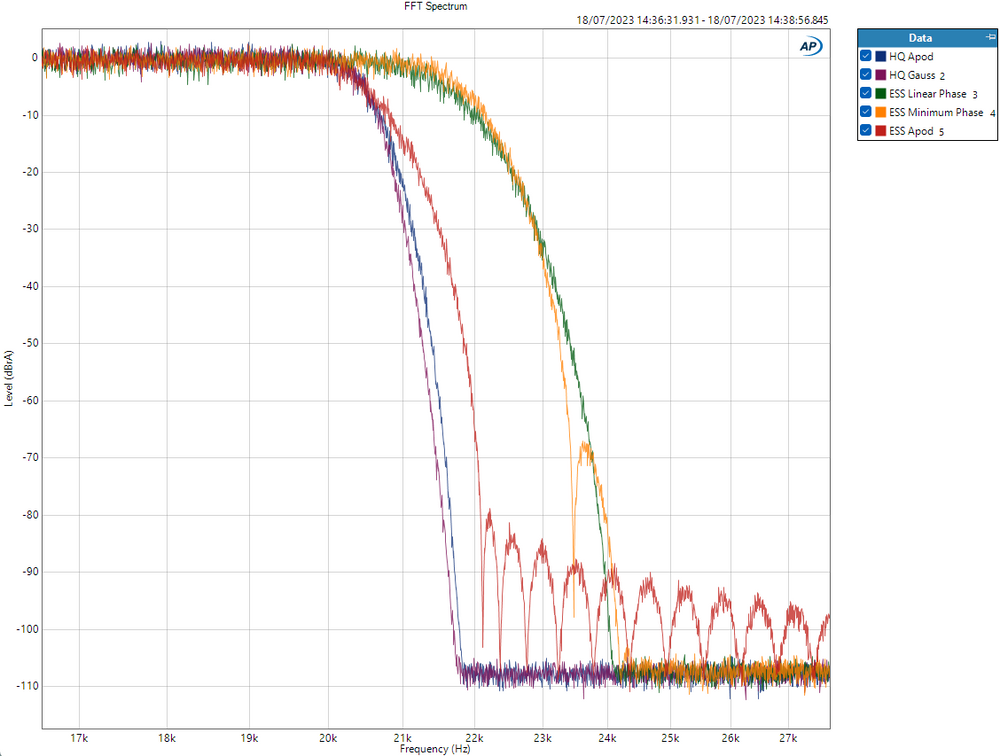

Reconstruction Filter (Nyquist/Oversampling Filter)
This is one of the main selling points of the WANDLA. Most DACs do not have a reconstruction filter that truly adheres to Nyquist theory. Meaning they either do not fully attenuate by 22.05khz, or they roll off early, attenuating treble in the audible band. You can see that none of the ESS filters adhere to Nyquist theory, however both the ‘HQ Apod’ and ‘HQ Gauss’ filters do achieve a full 96dB (16 bit) attenuation by 22.05khz, and probably more given as we are actually limited by analog noise here in terms of how far down we can see.
HQ Apod filter fully attenuates by 22.05khz, whilst not rolling off under 20khz

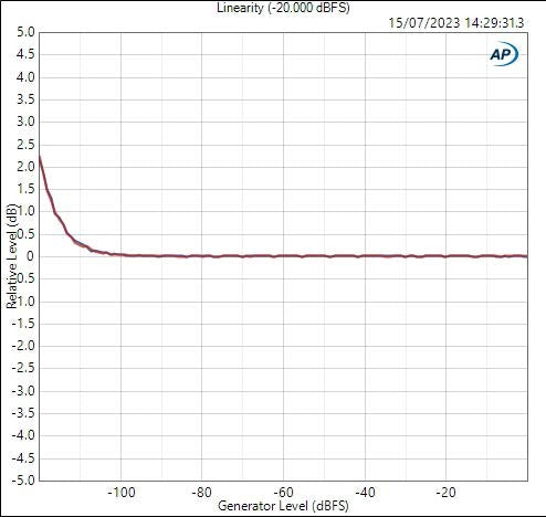

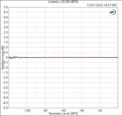

Linearity
This test plays a 1khz tone through the device, and steps down the level in small increments. Linearity measures how accurately the actual output of the device reflects the intended output. For example, if the level was stepped down by 20dB, but the output of the device was 19.7dB quieter, there is a 0.3dB nonlinearity, which would show as a 0.3dB rise on the graph.
Bandpass filtered, this is measuring only the accuracy of the 1khz tone itself
No bandpass filter, this factors in noise into the result

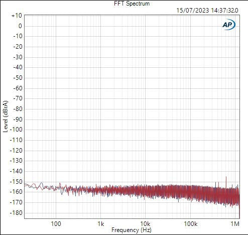

Noise
256k FFT, 3 Averages
No switching noise or other sources of noise observed upto 1Mhz.

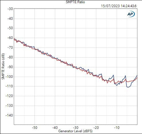

IMD
