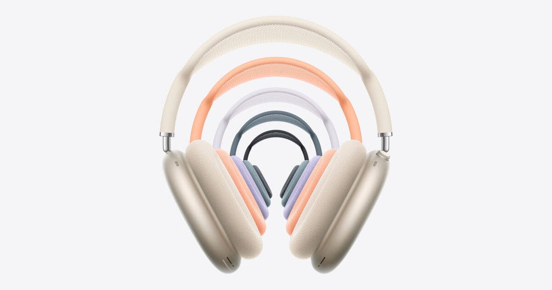

Most people are familiar with the original AirPods Max at this point, along with the USB-C refresh last year. This year they’ve come out with the AirPods Max 2, which promises some additional improvements. Naturally, we had to buy one to check it out.
I’m going to first point to our resident Apple AirPods enthusiast @listener’s article for the non-sound related aspects, and why he wishes this were a more substantial redesign. The AirPods Max 2 seems more iterative than anything meaningful. It looks, feels, and behaves in a very similar way.
But there are actually some improvements to the sound.
