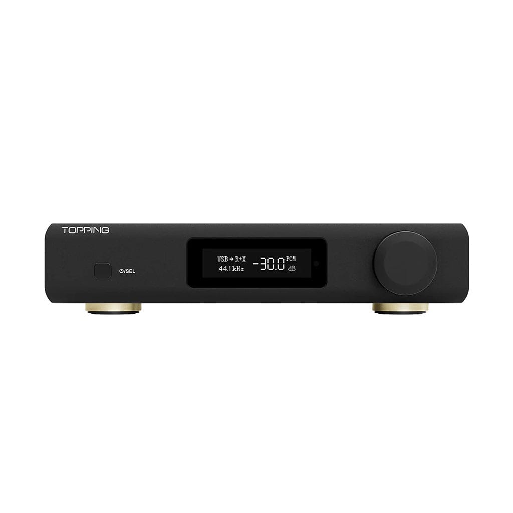

Experience unmatched audio fidelity with the Topping D90III Discrete Desktop DAC, featuring revolutionary PSRM technology. Utilizing a fully discrete 16-phase, 1-bit DAC module for each channel, the D90III ensures precise and unaltered signal reproduction. With a remarkable signal-to-noise ratio (SNR) of 131dB and dynamic range (DNR) of 130dB, this DAC delivers crystal-clear audio, capturing every subtle nuance in your favorite music.

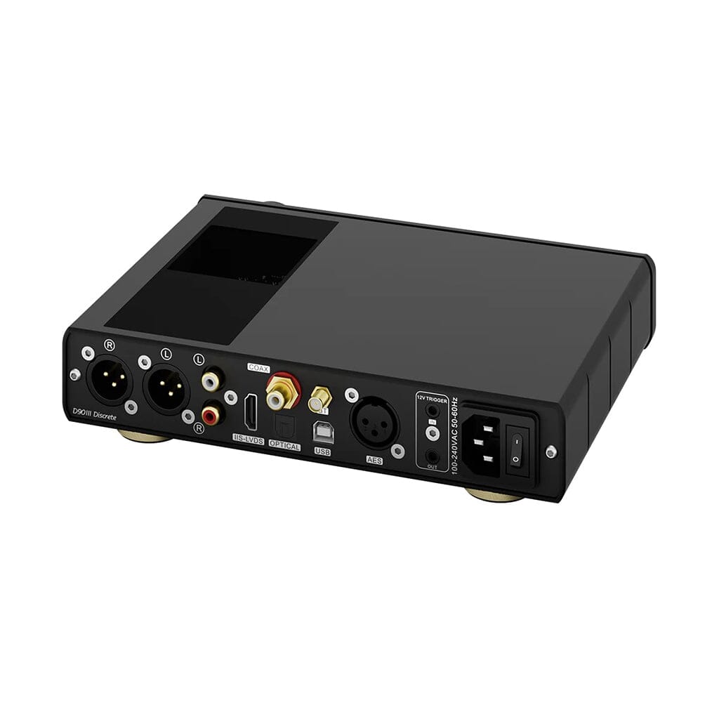

Versatile IIS Digital Input Interface
Expand your connectivity options with the D90III’s advanced IIS interface. Supporting PCM768kHz/32bit and native DSD512 formats, this specially-designed interface offers seamless integration with various digital audio systems. Multiple IIS modes enhance compatibility and ensure optimal audio signal transmission in complex setups.
Flexible Outputs for Every Setup
Equipped with both balanced XLR and single-ended RCA outputs, the D90III offers versatile connectivity and selectable output voltages (XLR 5V, RCA 2.5V). Whether connecting to professional studio equipment, high-end amplifiers, or consumer audio devices, this DAC provides exceptional adaptability and performance to suit your unique audio setup.
Integrated Preamp Functionality
Simplify your audio system with the integrated preamplifier mode of the Topping D90III. Easily connect directly to active speakers or power amplifiers, eliminating the need for an external preamp. With convenient volume adjustments available via the Bluetooth remote, enjoy a streamlined and efficient listening experience.
Seamless Device Integration with 12V Trigger
The Topping D90III is designed with a convenient 12V trigger input and output, allowing seamless power synchronization with other compatible audio equipment. Simplify your system management by enabling coordinated on/off operation, ensuring your entire audio setup is always perfectly synchronized.
Effortless Control with Bluetooth Remote
Control your audio setup effortlessly from anywhere in the room using the included Bluetooth remote. The 2.4G connectivity ensures smooth, obstacle-free operation, providing convenient access to essential functions, allowing you to sit back, relax, and immerse yourself completely in the music.
