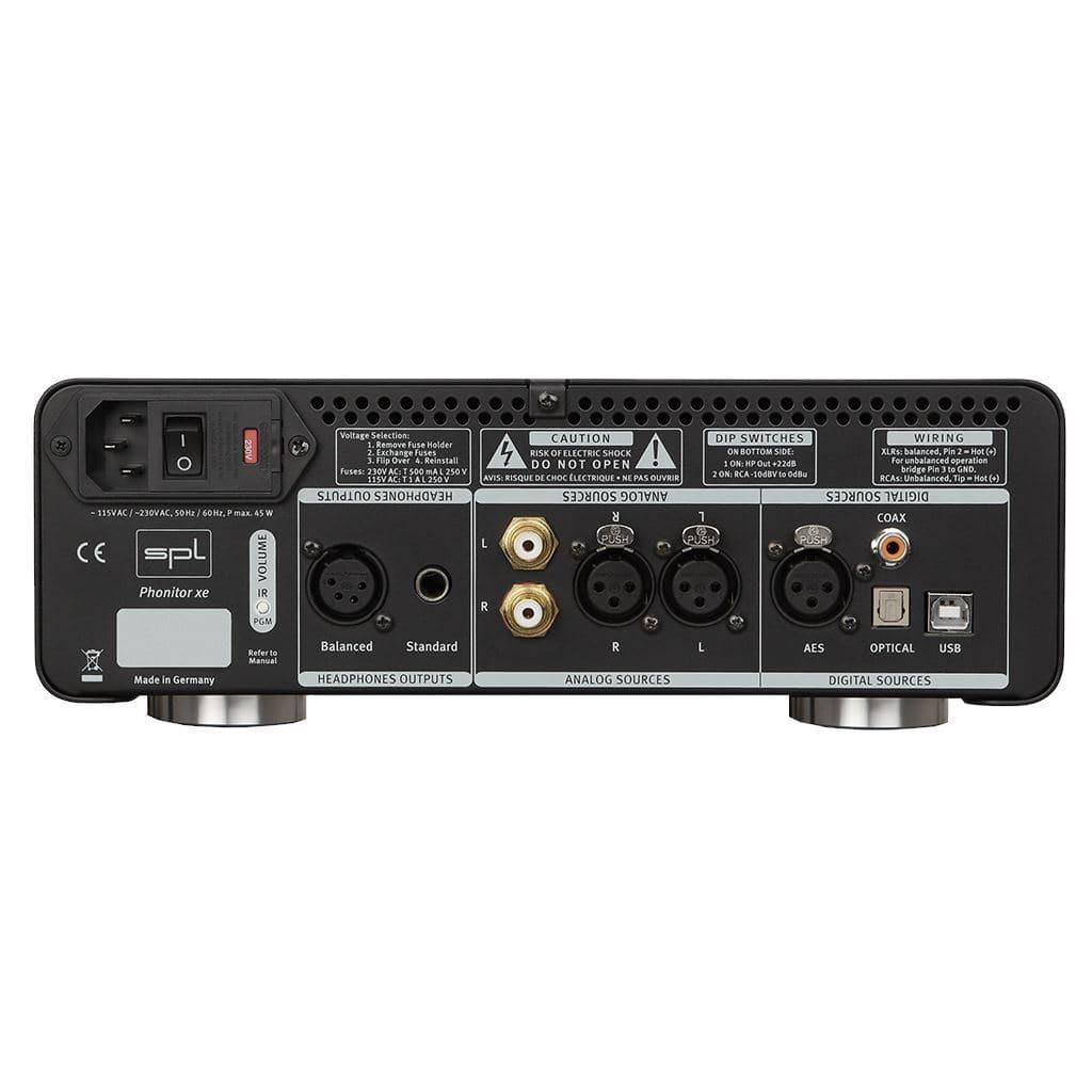

XLR inputs
  • Neutrik XLR, balanced, Pin 2 = (+)
  • Impedance: ca. 20 kohms
  • CMR: -82 dBu (at 1 kHz)
  • Max. Input level: +32.5 dBu
  • RCA inputs
  • Unbalanced
  • Impedance: ca. 10 kohms
  • Digital inputs (optional) / sample rates
  • Coaxial SPDIF (RCA) - sample rates PCM (kHz): 44.1, 48 , 88.2, 96, 176.4, 192
  • Optical TOSLINK (F06) sample rates PCM (kHz): 44.1, 48 , 88.2, 96
  • USB (B) PCM sample rates (kHz): 44.1, 48 , 88.2, 96, 176.4, 192, 352.8, 384, 705.6, 768
  • DSD 1, 2 and 4 (DoP)
  • AES sample rates PCM (kHz): 44.1, 48 , 88.2, 96, 176.4, 192
Balanced headphone output
  • Neutrik 4-pin XLR connector (front and rear side)
  • Pin wiring: 1 = L (+), 2 = L (-), 3 = R (+), 4 = R (-)
  • Impedance: 0.36 ohms
  • Damping factor: 180 @ 40 ohms
  • Frequency range: 10 Hz to 300 kHz ( -3 dB)
  • Crosstalk at 1 kHz: -90 dB
  • THD & N: 0.00082 % (at 0 dBu, 1 kHz, 100 kohms load)
  • Noise (A-weighted): -98 dBu
  • Dynamic range: 130.5 dB
Standard headphone output
  • 6.35 mm TRS connector (front and rear side)
  • Pin wiring: Tip = Left, ring = right, sleeve = GND
  • Impedance: 0.18 ohm
  • Attenuation factor: 180 @ 40 ohms
  • THD & N: 0.00082% (at 0 dBu, 1 kHz, 100 kohms load)
  • Noise (A-weighted): -103 dB
  • Dynamic range: 135.5 dB
  • Max. Output power (at +30 dBu @ 1 kHz)
  • 2 x 1 W at 600 Ohm impedance
  • 2 x 2 W at 300 Ohm impedance
  • 2x 3.7 W at 120 Ohm impedance
  • 2x 2.9 W at 47 Ohm impedance
  • 2x 2.7 W at 32 Ohm impedance
Internal operating voltages
  • Analog: +/- 60 V
  • Digital: + 5 V and + 3.3 V (optional DAC768)
Power supply
  • Mains voltage (switchable): 230 V AC / 50 Hz or 115 V AC / 60 Hz
  • Fuses: 230 V: T 500 mA; 115 V: T 1 A
  • Power consumption: max 40 VA
  • Stand-by power consumption: 0.7 W
