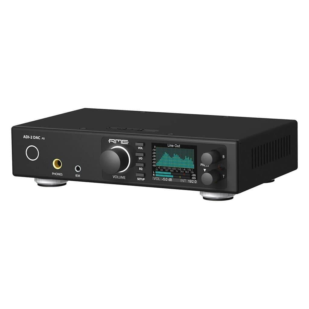

The RME ADI-2 DAC includes an improved SteadyClock, a fine-tuned to perfection analog circuitry, new MRC remote control, Extreme Power headphone output and a very special IEM output. It has all the bells and whistles that made the ADI-2 Pro famous, including its perfectly transparent sound signature and full DSP processing with Bass, Treble, Loudness, 5 Band Parametric EQ, Crossfeed and much more. With its simplified operation and stunning design it is the ideal center piece from home listening up to studio reference playback.
Connectivity and Features
The ADI-2 DAC is the home and hi-fi optimized version of the ADI-2 Pro, a studio AD/DA converter of the highest quality. With many fresh ideas, innovative features and numerous useful functions, the ADI-2 DAC quickly became the reference. Thanks to its combination of high-end DA conversion with two exceptional headphone IEM outputs and a remote control, it has received countless enthusiastic reviews for its sound, flexibility, and technical capabilities.
The current version of the ADI-2 DAC comes with an extended remote control, a further improved DA conversion and an adapted analog output stage for even better noise and distortion values. To address the home and HiFi users, RME exchanged some of the Pro's studio features with typical home and HiFi ones. With an adapted feature set and much simplified operation RME proudly presents the ADI-2 DAC. Built on the technology, concept and features of the ADI-2 Pro, the DAC concentrates on DA conversion in top high-end quality, along with two exceptional headphone and IEM outputs.
The DAC

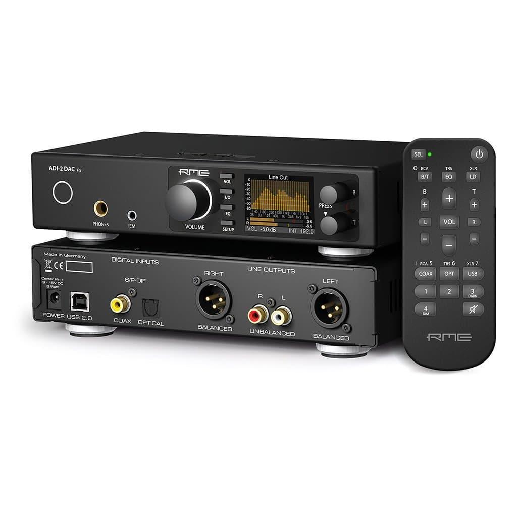

Packed into the compact half 19” format factor, this little gem is filled with the finest high-end electronics, offering a reference class conversion from SPDIF coaxial, SPDIF optical (ADAT compatible) and USB to RCA, XLR, TRS and mini-TRS.
As the most versatile DAC available, the ADI-2 DAC offers balanced/unbalanced analog I/Os, an Extreme Power headphone output, a super low noise IEM output, SteadyClock FS, 4-stage hardware output level control, DSP-based signal processing, external power supply operation, Class Compliant USB compatibility, sample rates up to 768 kHz as well as DSD and Direct DSD playback. The SPDIF input signal can even be recorded via USB - as one would expect from RME the DAC is a true 2 channel Full Duplex audio interface.
Improving DA
The updated ADI-2 DAC uses ESS's ES9028Q2M in a special circuit variant developed by RME engineers that allows the chip to perform at its best. With noise levels of 123 dBA, distortion less than -120 dB, or THD+N of -116 dB, the device delivers outstanding measured values. Even the IEM output, with -118 dBu already the world's lowest noise headphone output, improves to a sensational -121 dBu. In addition, there is 4 dB of digital headroom, so that even high intersample peaks do not produce any audible distortion. Finally, the device now also offers a clear reserve in volume setting. +2.5 dB result in a still undistorted analog output signal.
All these improvements are completely transparent in the previous menu navigation. There are no changes in operation, features and behavior compared to the predecessor, which is why neither appearance nor name have changed. The only difference: with 'Low Dispersion' another digital filter is available for selection. Explanations for this filter can be found in the detailed manual of the ADI-2 DAC.
Super Low Noise for IEM lovers
The headphone revolution not only brought headphones but also IEMs (in ear monitors) back into the attention of audiophiles and music lovers. Modern IEMs have a reference sound that easily competes with bulky over-ear headphones, making them not only a mobile alternative, but also an interesting solution in home.
Modern IEMs are extremely sensitive and operate on very low voltages. As a side effect they uncover the noise floor of the player, DAC or headphone amp. When RME developed its Extreme Power headphone stage the basic noise floor was taken care to be as low as possible. Which was then confirmed in many reviews (most black background…). Even when used with IEMs.
Still RME wanted to make sure that even the most sensitive IEM combined with the most sensitive listener receive the full dynamic range on playback. Also capable outputs like the Extreme Power ones are not fully safe against operating errors and might blow up ears or IEMs.
RME's solution: adding the most advanced IEM output imaginable as second phones connection to the front of the ADI-2 DAC. Its ground noise floor is an astounding 10 dB lower than the one of the Extreme Power output (black hole background…), output impedance is near zero Ohms, THD reaches new record lows, click-free on/off is included as well as volume ramp-up, and the sound quality with any IEM is just amazing. We're sure you will love it!
