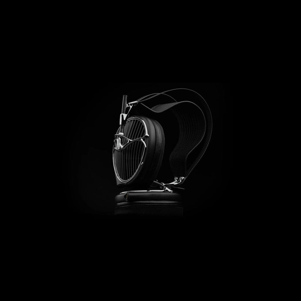

The Meze Audio ARTA is a flagship open-back planar magnetic headphone created for listeners who want the scale and spatial freedom of a high-end loudspeaker system without losing the texture, immediacy, and fine detail of headphone listening. Its warm-neutral tuning, physical bass response, and expansive three-dimensional soundstage are designed to place music around the listener rather than confine it between the ears.
Developed in collaboration with Rinaro Isodynamics, ARTA introduces the MZ5 HΩ High Impedance Isodynamic® Hybrid Array driver. This new 225-ohm transducer combines an unusually high-impedance planar architecture with a lightweight diaphragm, high-density voice-coil trace, and carefully controlled open-back acoustic structure. Meze then surrounds that technology with two distinct earpad tunings, premium materials, fully serviceable construction, and the sculptural design language that has defined its most ambitious headphones.

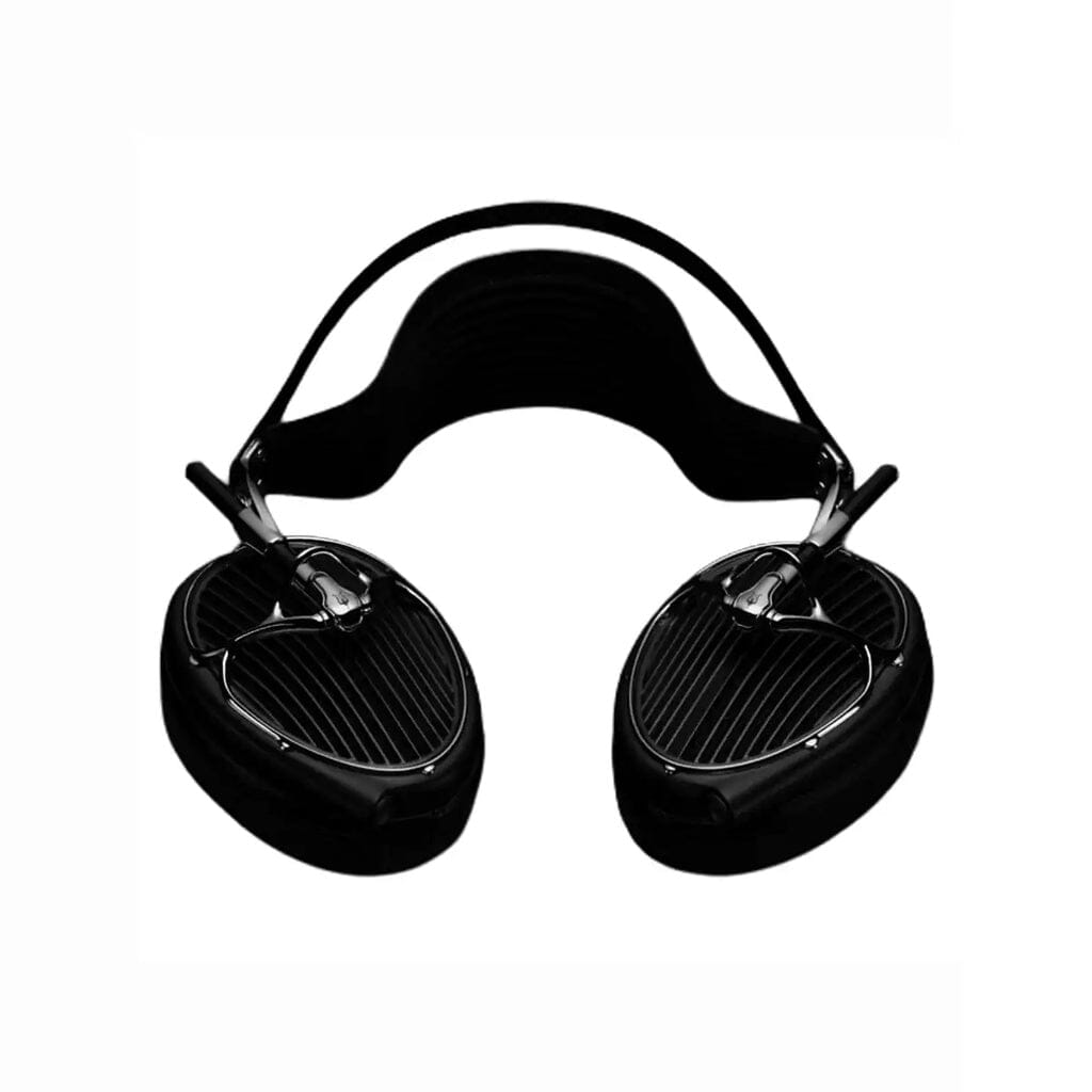

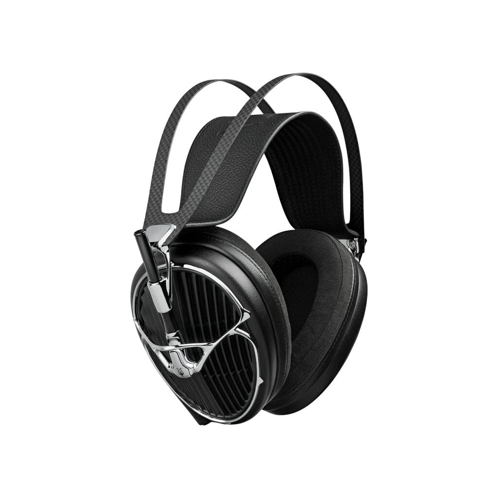

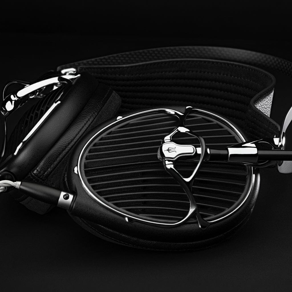

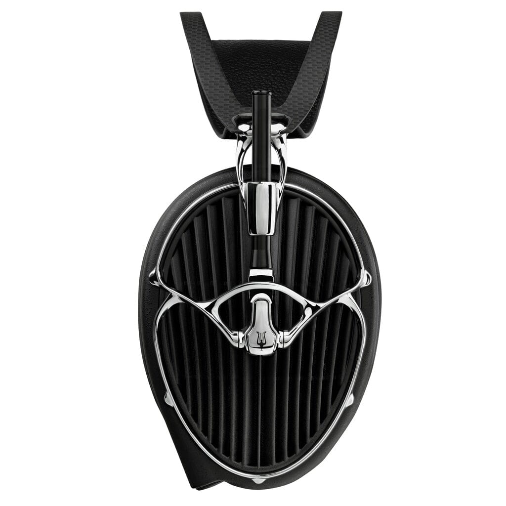

Angled Acoustic Blades for a Cleaner Open-Back Design
ARTA’s exterior grille is formed from precisely angled acoustic blades that protect the driver while allowing its rear wave to disperse freely. Their geometry is designed to diffuse acoustic energy and reduce reflections that could otherwise return toward the diaphragm.
By controlling the acoustic path without heavily obstructing it, the grille supports cleaner transients, stable imaging, and a more naturally open presentation. The driver and enclosure work as a complete acoustic system, preserving the MZ5 HΩ transducer’s precision rather than limiting it with unnecessary internal reflections.

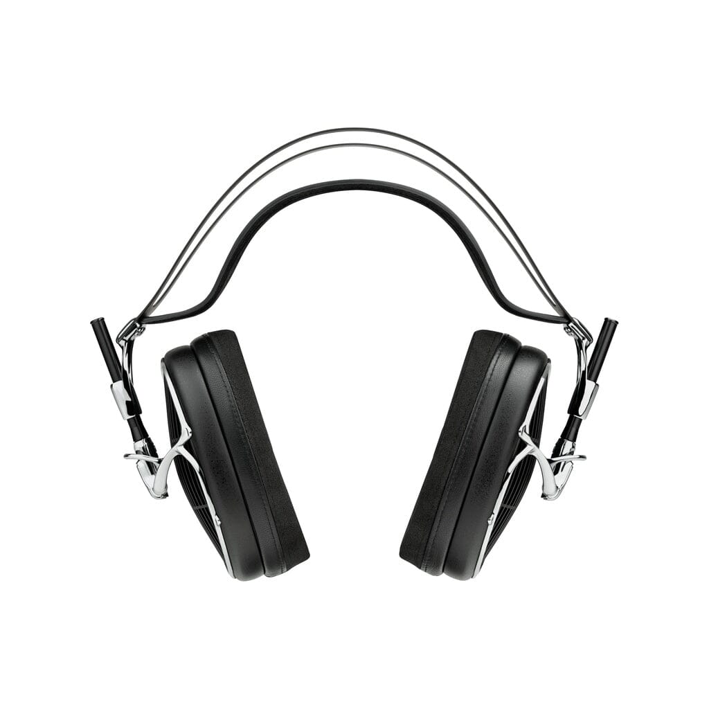

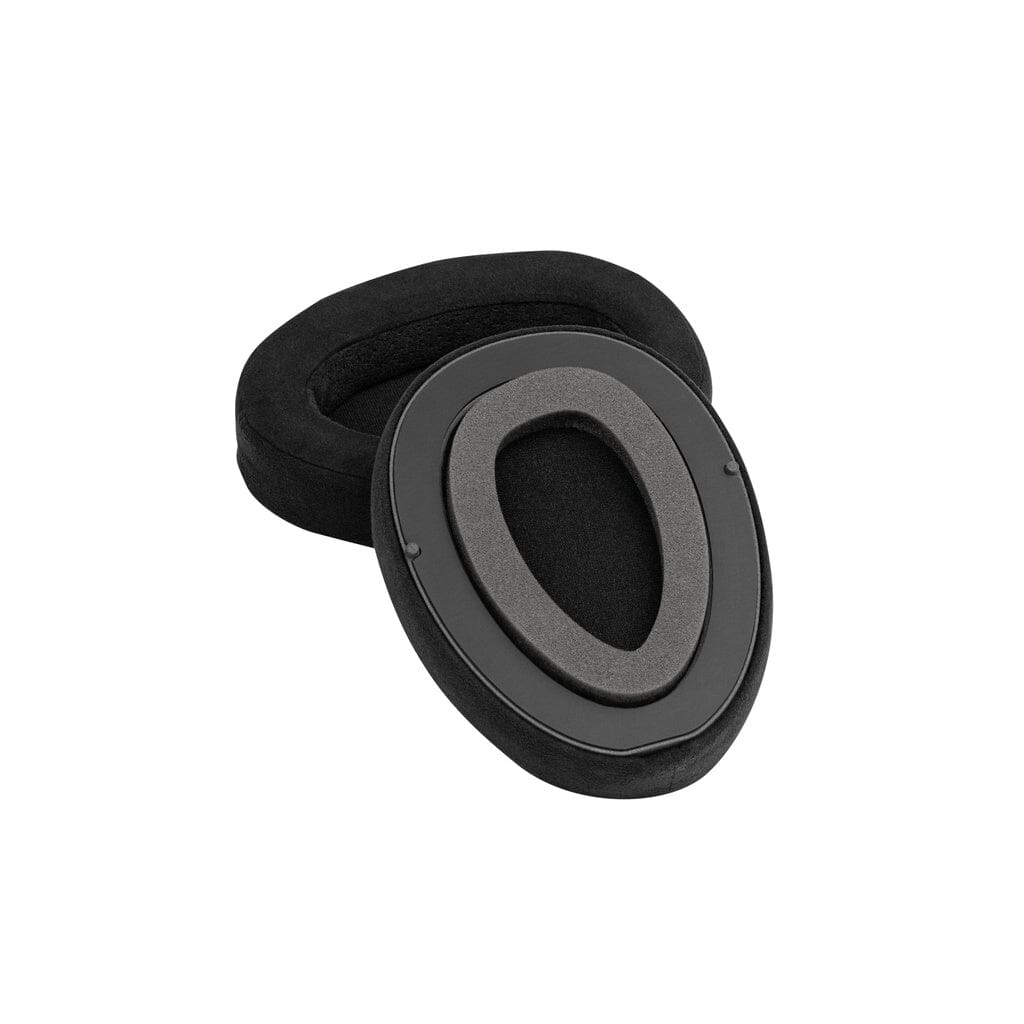

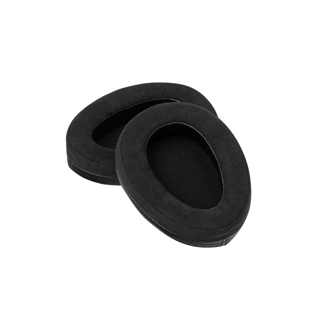

Two Earpad Tunings
ARTA includes two carefully developed earpad designs that allow the listener to adjust its tonal balance without software, filters, or internal modifications.
  • Duo Angled: Combines perforated lambskin leather and Alcantara® in an angled profile. This configuration provides a richer, more impactful presentation with greater physicality and presence.
  • Slim Alcantara: Uses two types of Alcantara® with perforations along the inner chamber. This configuration offers a more neutral balance with a smoother, rounder upper-frequency presentation.
Both pad options are designed as complete acoustic tunings rather than simple material changes. Switching between them gives ARTA two distinct but closely related interpretations of its core sound.
Sculptural Design, Built for Long-Term Ownership
ARTA combines futuristic, organic forms with the flowing lines and ornamental restraint of Art Nouveau design. Precision-machined metals, carbon fiber, and premium leather are integrated into a structure that feels sculptural while remaining functional and wearable.
Its 495g weight is supported by an enhanced padded leather headband and a suspension system designed to distribute pressure across a broad area. The circumaural earpads surround the ears, while the open-back structure helps limit heat buildup during extended listening sessions.
Every major component, including the earpads, headband, drivers, earcups, and structural parts, can be disassembled, serviced, or replaced. Acoustic tuning, mechanical design, quality control, and final assembly take place at Meze Audio’s headquarters in Baia Mare, Romania. ARTA is built as a long-term reference headphone rather than a product intended to be discarded when a wearable or mechanical part eventually requires service.

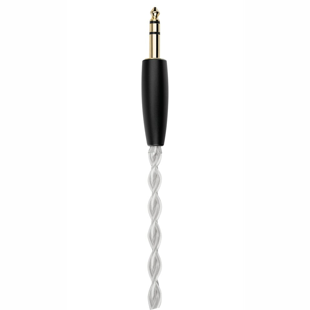

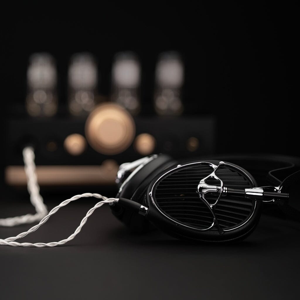

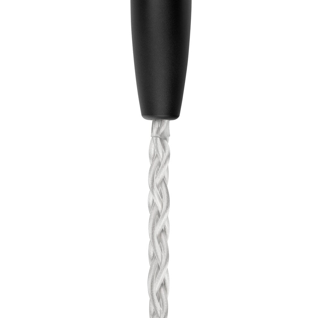

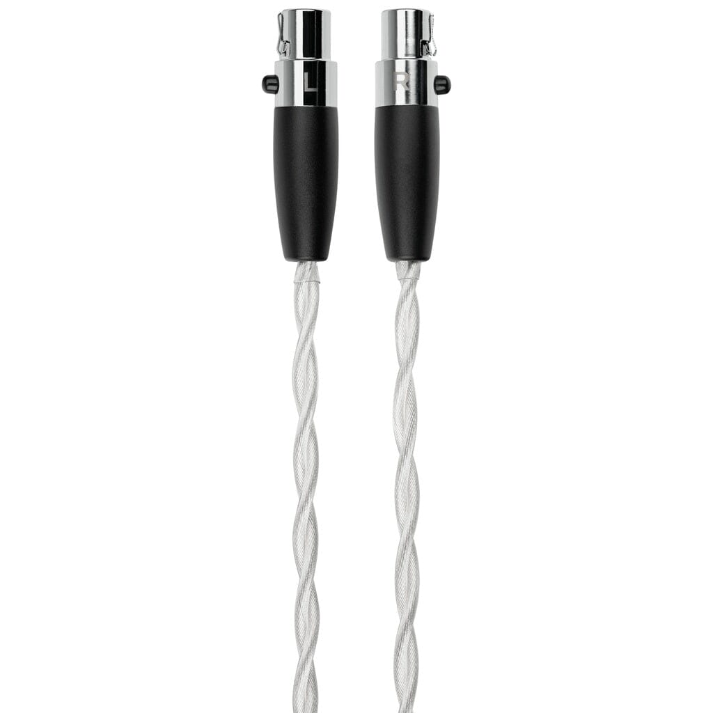

Two Premium Cables Included
ARTA includes two 2m cables built with silver-plated Linear Crystal Oxygen-Free Copper conductors. Each cable uses a dual-strand configuration with 161 individual conductors per strand, SoftFlex PVC insulation, and CNC-anodized aluminum connector housings.
One cable terminates in a 6.3mm single-ended plug, while the second uses a 4-pin XLR balanced connector. Both connect to the headphones through dual 4-pin mini-XLR inputs, providing dedicated options for single-ended and balanced desktop systems.
