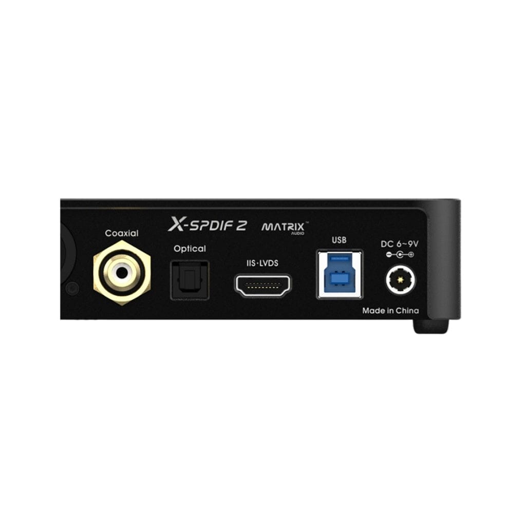

  • Direct I2S LVDS HDMI output to avoid protocol conversion loss

  • Optional external power supply with automatic USB power disconnect
  • CNC-machined aluminum chassis for durability and EMI shielding

Technical specifications
USB input USB 2.0 High Speed, PCM up to 32bit / 768kHz, DSD64 to DSD512
AES/EBU output 110Ω balanced XLR, PCM 16 to 24bit up to 192kHz, DSD64 (DoP)
Coaxial SPDIF output 75Ω, PCM 16 to 24bit up to 192kHz, DSD64 (DoP)
Optical Toslink output PCM 16 to 24bit up to 192kHz, DSD64 (DoP)
I2S HDMI LVDS output PCM 16 to 32bit, 44.1kHz to 768kHz
DSD64, DSD128, DSD256 (DoP)
DSD64, DSD128, DSD256, DSD512 (Native)
Clock system Dual Accusilicon femtosecond clocks for 44.1kHz and 48kHz families
Power requirements USB bus power 5V / 500mA or external DC 6 to 9V, ≥800mA
Power behavior USB power automatically disconnected when external power is used
