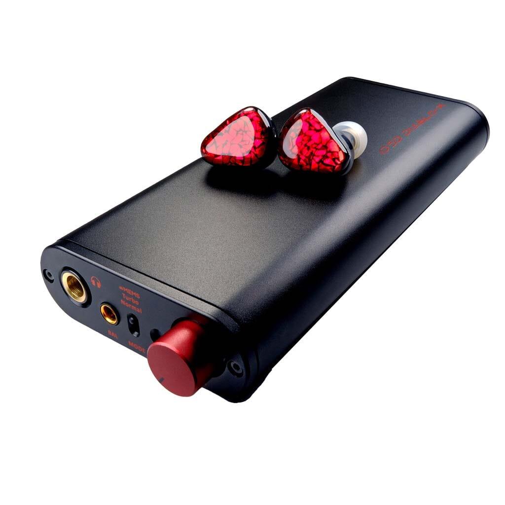

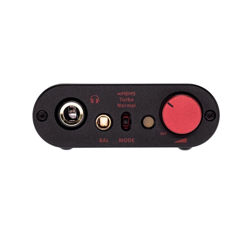

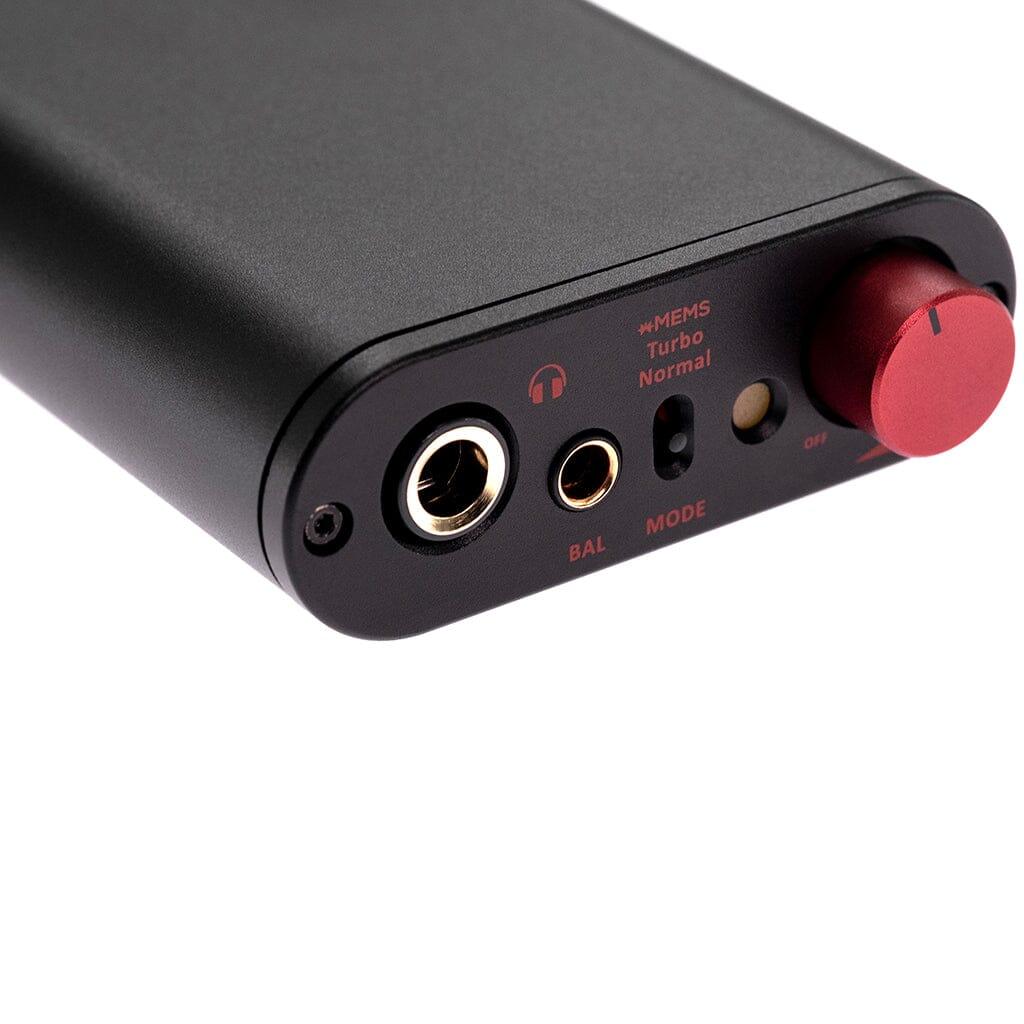

    Able to drive all manner of headphones with ease, including those incorporating the new XMEMs tech, the Diablo-X sports fully balanced 4.4mm outputs with 4,100mW of power.
    Three modes are used to adjust power and gain.
    • xMEMS – use with compatible IEMs/headphones
    • Turbo – ramps up the level of drive for current-hungry headphones
    • Normal – for most over or on ear headphones

    At the front of the unit, alongside a standard 6.3mm single-ended headphone socket, resides a 4.4mm Balanced output for headphones offering balanced connection.

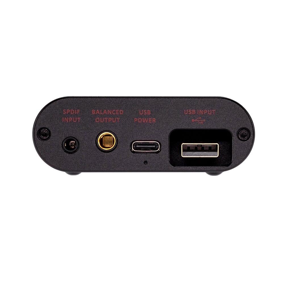

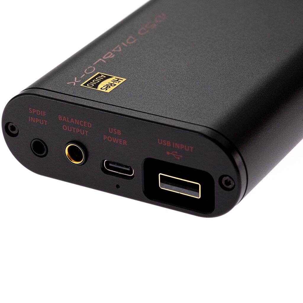

    At the back are two digital audio inputs: USB-A and a S/PDIF socket that accepts both electrical and optical signals, the former via a 3.5mm connector and the latter via a supplied adapter.
    The USB-A input features a ‘male’ connector, rather than a typical ‘female’ port for greater mechanical integrity. A separate USB-C charging port is also provided, along with a 4.4mm Balanced output to connect to an external amp.
