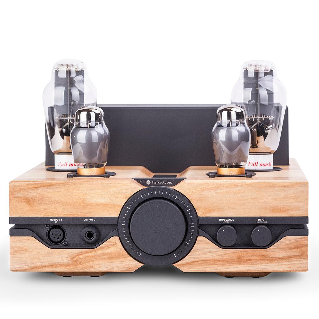

The Feliks Audio Envy is built on a solid metal chassis and finished with a natural high quality oiled wood. On the Envy's front panel there are two headphone outputs: Balanced 4-Pin XLR and Single-Ended (unbalanced) with a 1/4" (6.35mm) output. Other selectors located on the front of the Envy include: touch sensitive stand-by button, volume control knob, impedance selector and audio source selector. The audio source selectors allows choices of one of the three options: unbalanced RCA source (IN1 or IN2) and balanced XLR (IN3, left and right channels).
The touch sensitive stand-by button has a LED indicator. For a full "power off" of the amplifier please use the physical switch on the rear panel of the amplifier, near the AC connector.

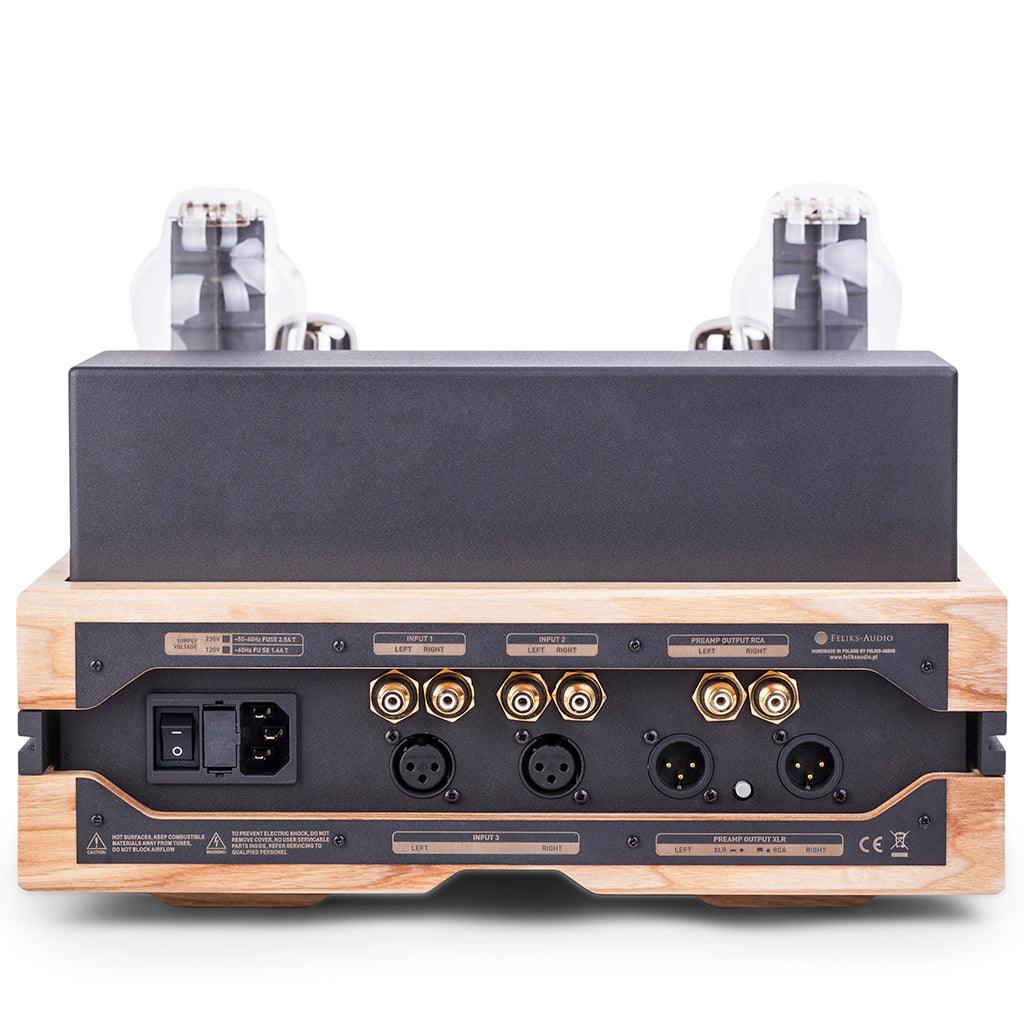

Envy can work as pre-amplifier with a high level of maximum output (up to 10V RMS). On the rear panel there is a pair of RCA pre-amplifier outputs as well as two XLR connectors for balanced pre-amplifier output. Output voltage level is regulated with the volume knob.
