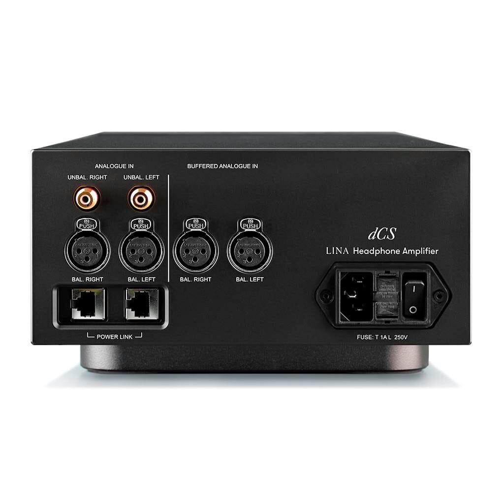

• 1 x stereo pair unbalanced RCA, input impedance 48kΩ • 1 x stereo pair unbuffered balanced XLR, input impedance 16kΩ • 1 x stereo pair buffered balanced XLR, input impedance 96kΩ |
Headphone Outputs |
• 1 x dual 3-pin balanced XLR, right and left channel • 1 x single 4-pin balanced XLR • 1 x single ¼” (6.35mm) headphone jack |
Power Link (synchronising on/off state with other products) | • 2 x RJ45 |
