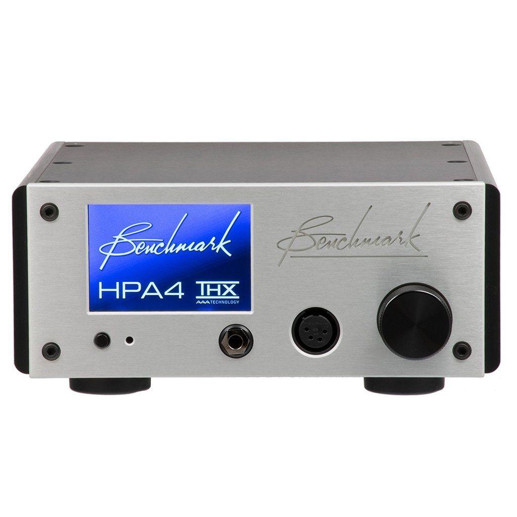

THE ULTIMATE HEADPHONE AMPLIFIER
Benchmark Media Systems, Inc. and THX, Ltd. have partnered to introduce the Benchmark HPA4 headphone/line amplifier featuring THX Achromatic Audio Amplifier (AAA™) technology.
THX AAA™ reduces harmonic, intermodulation, and crossover distortion by 20 to 40 dB to guarantee a realistic and fatigue-free listening experience. It accomplishes this using a patented feed-forward topology to null conventional distortion and noise mechanisms, resulting in the world's most linear amplifier. THX AAA allows the amplifier to reach its maximum output power and sound pressure level (SPL) without producing the distortion that normally accompanies increased output levels in traditional amplifiers.
Featuring the flagship THX-888 amplifier design, the revolutionary HPA4 headphone amplifier (SILVER) incorporates the same THX AAAtechnology that Benchmark uses in the AHB2 power amplifier. The HPA4 delivers sonic perfection. Hear the music without any contamination from electronic noise or distortion. The HPA4 (SILVER) delivers power, audio fidelity, speed and accuracy over an utterly silent background.

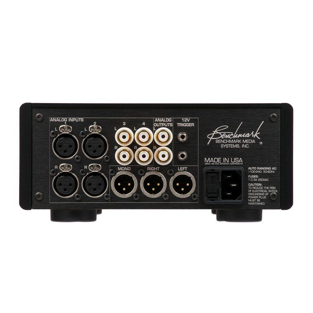

BALANCED AND UNBALANCED I/O
The headphone output of the THX-888 amplifier features a 1/4" TRS and a 4-pin XLR. Both outputs deliver the full performance of the HPA4 (SILVER). However, we recommend the XLR4 due to its lower contact resistance. The HPA4 (SILVER) features two balanced stereo inputs and two unbalanced stereo inputs. The line amplifier provides one balanced stereo output, one balanced mono sum, and one unbalanced stereo output.

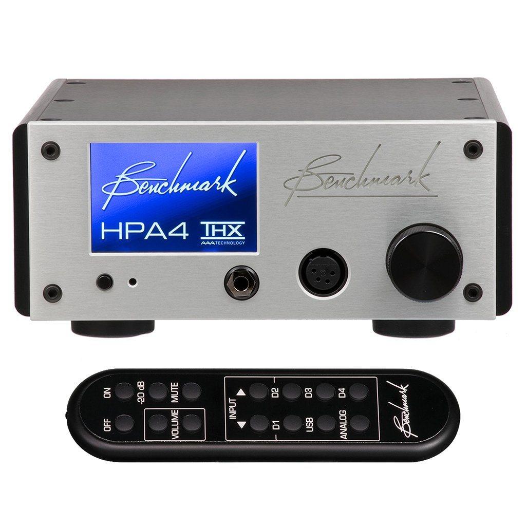

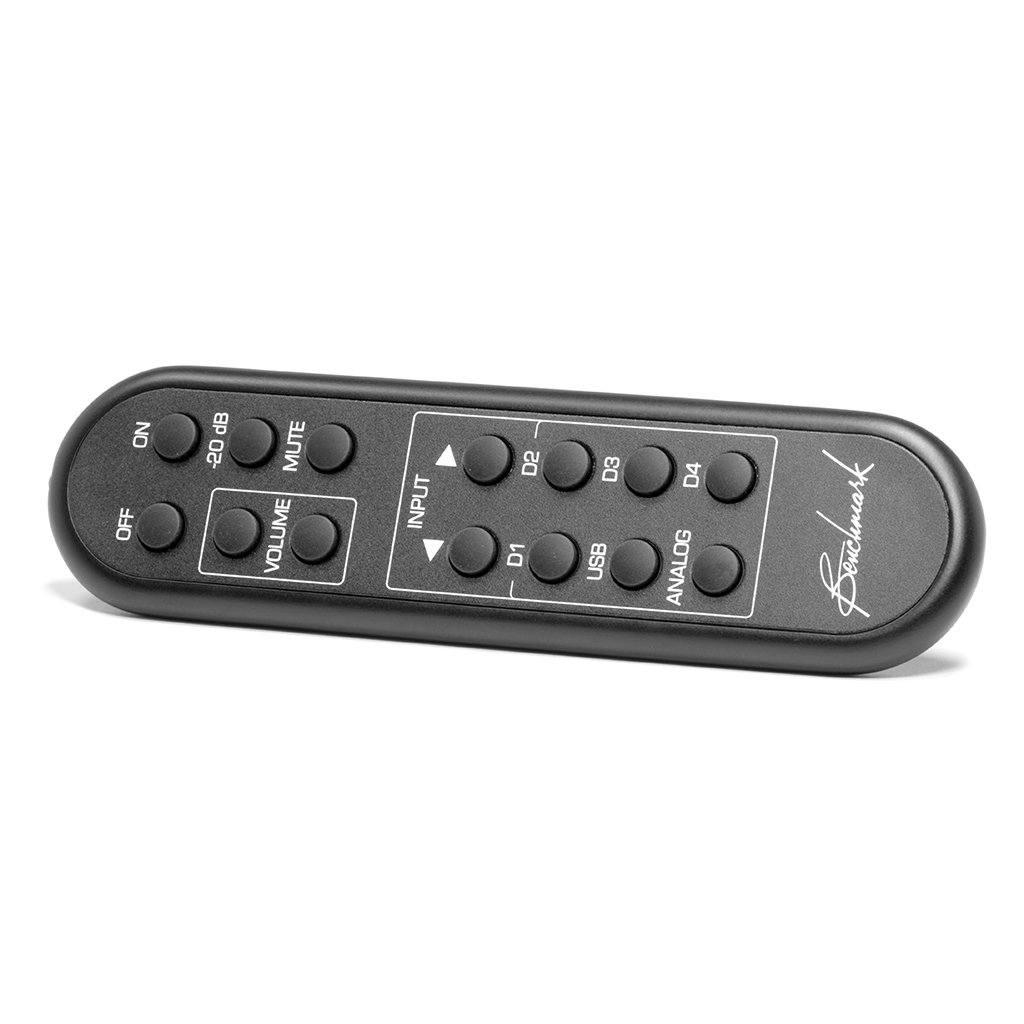

The HPA4 includes IR remote control and can be operated using the optional Benchmark remote. The HPA4 is designed to work with the Benchmark DAC2 and DAC3 converters but may be driven from any high-end D/A converter. When paired with a Benchmark DAC, a single remote control will operate both units.

Two bidirectional 12V trigger ports can be used to link the HPA4 with external D/A converters and power amplifiers. The trigger signal controls the power-up and power-down sequencing of the entire audio system. The trigger ports are compatible with most industry-standard trigger input or output ports, but can communicate bidirectionally with other Benchmark products.

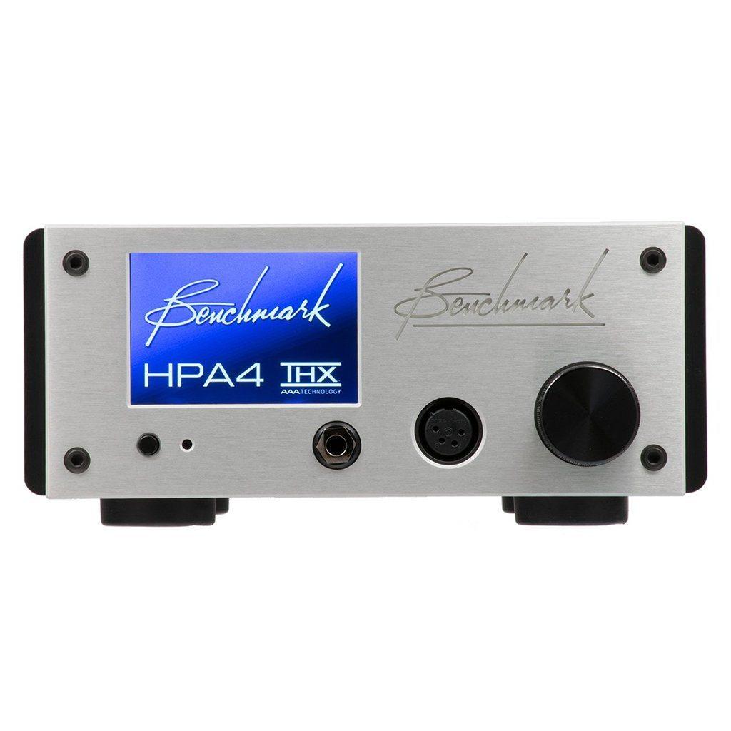

TOUCH SCREEN
The touch screen provides easy access to advanced features such as balance control, input level offsets, input names, screen dimming, remote control, and function locking. Help screens explain the special functions.
ROTARY ENCODER
The volume control knob features a high-quality optical encoder that is rated for heavy use. An acceleration feature makes it easy to move through the 256 volume steps while maintaining 0.5 dB/step resolution. A press of the control knob toggles between headphone volume, line out volume, or both.
CONVENIENCE FEATURES
The HPA4 includes independent on-screen mute buttons for the headphone and line outputs. Both can also be muted with the volume knob or with the optional remote control.
The HPA4 includes an on-screen -20 dB dim button that instantly reduces the level by 20dB. This function provides a temporary volume reduction and an easy return to the previous listening level. This control makes it easy to transition between a normal listening level and a background level. The dim function is also accessible from the optional remote control.

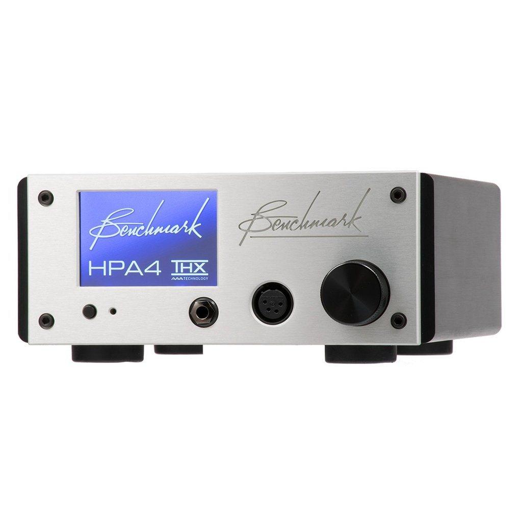

CASEWORK
The HPA4 is available with a black or silver faceplate and is designed to match the Benchmark AHB2 power amplifier. It occupies the same footprint as the Benchmark DAC1, DAC2 and DAC3 converters. The case features a milled faceplate and milled sides. Top, bottom, and rear panels are made from thick aluminum and feature a brushed texture. The HPA4 is built to last and will be a fine addition to your listening space.

POWER:
  • 18W Typical Input Power
  • 35W Maximum Input power
  • 0.33 W Standby Power (when off)
  • Internal Universal Power Supply
