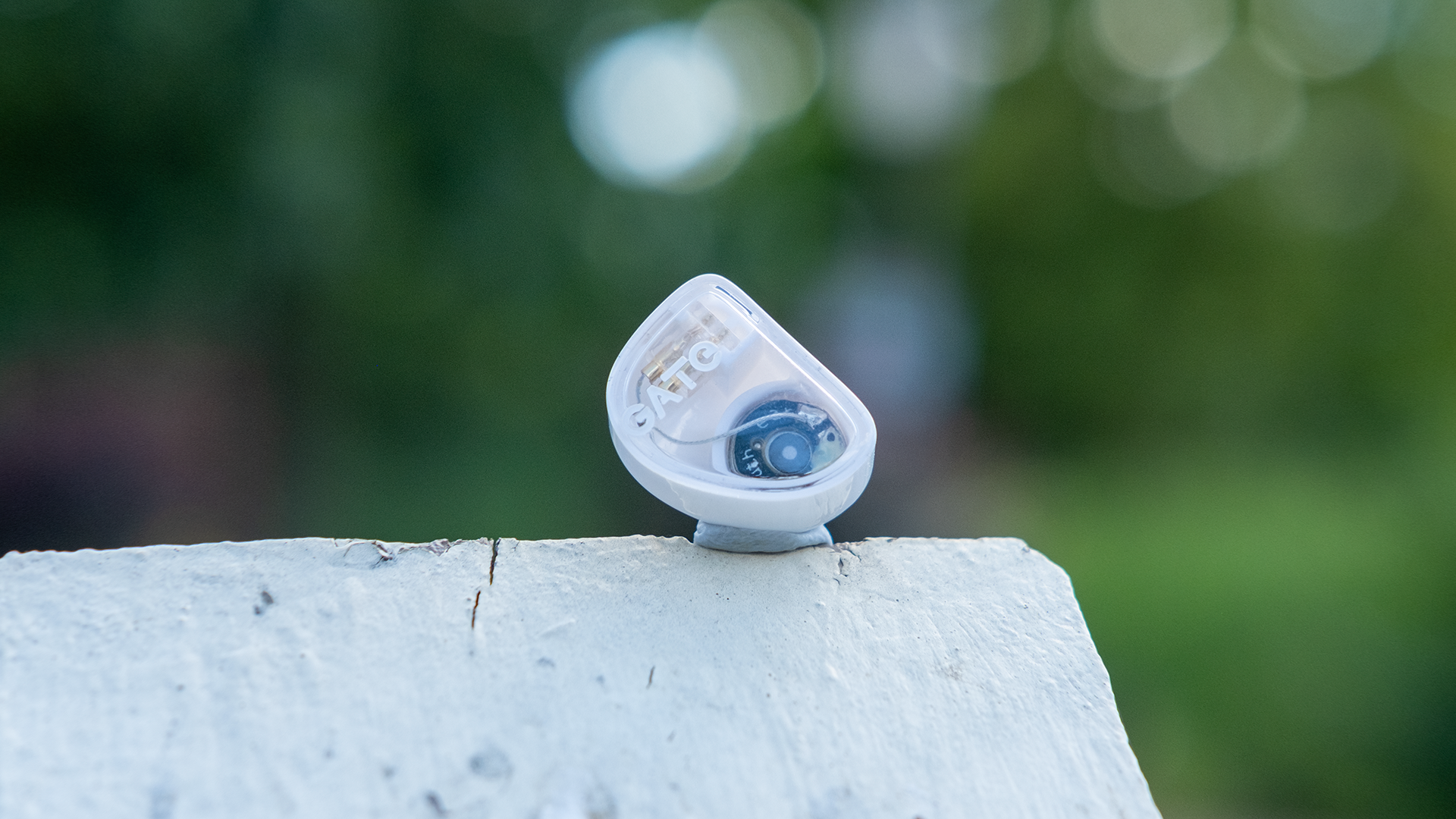

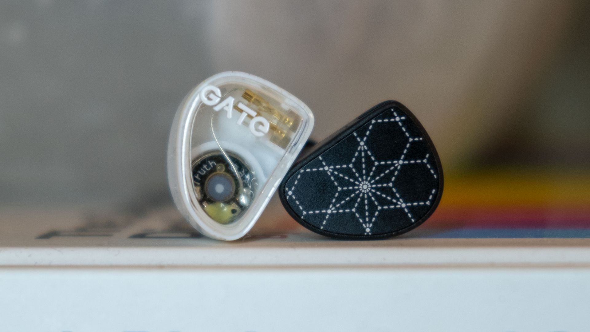

Let’s start with design, especially because this is one of the more contentious IEM designs that’s come out in the budget sphere in recent times. That’s not to say that it’s controversial, but that it’s hard to find a consensus; people either love it or they hate it. I personally love it, especially in the white configuration. The clear faceplate showing the rather simple internals with the white shell and white text overlay makes for an incredibly “clean” aesthetic that I feel like I could actually be happy wearing outside as an accessory—which can’t be said for a lot of IEMs, even more expensive ones.

Ergonomically, GATe is kind of a mixed bag despite how good the cable is. While yes, the cable goes a very long way to making the ergonomic experience better, the IEM’s nozzle is definitely on the wider side, and the back corner of the shell when inserted at a comfortable depth for me rubs against my antihelix a bit and causes discomfort after an hour or two. Definitely not terrible, and I think most people will find this plenty comfortable for the price, but it could definitely be better for me.
In terms of build, GATe unfortunately kind of feels like its price. I think it has something to do with the plastic used for the shell being lighter, but especially compared to its predecessor Hola, GATe feels meaningfully more lightweight and chintzy such that I’d not feel as comfortable dropping it as I would some other IEMs. Of course, it’s hard to review build quality after only one week with an IEM—the real story will be how it holds up in 6 months to a year—but for now I’d say anyone buying a GATe, or any $20 IEM, should be careful in order to maximize its chances of longevity.
