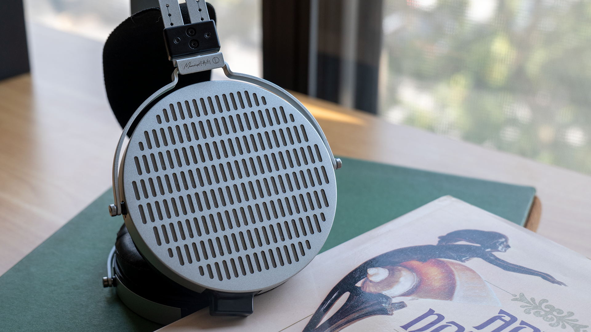

Build, Comfort, and Design

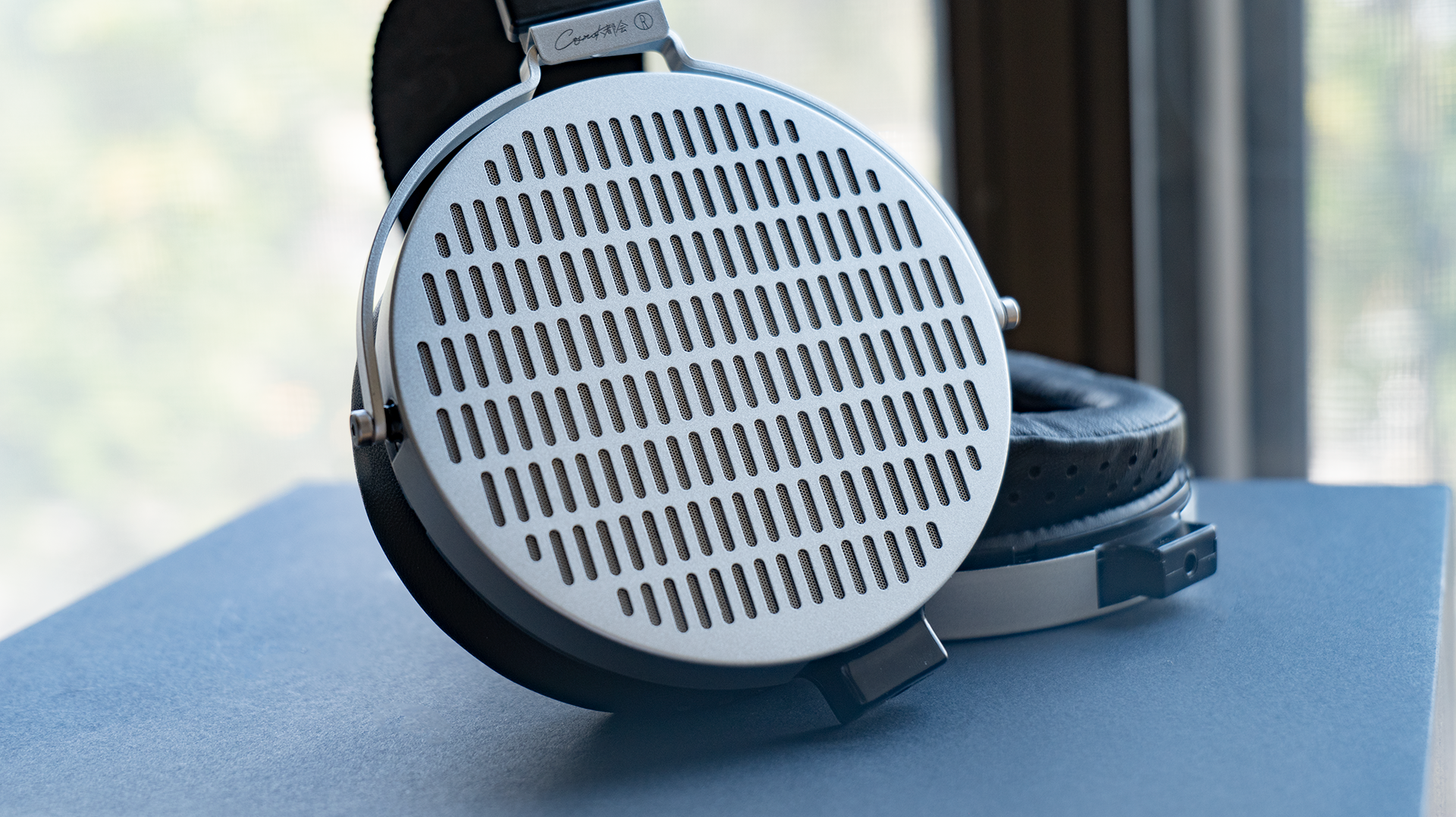

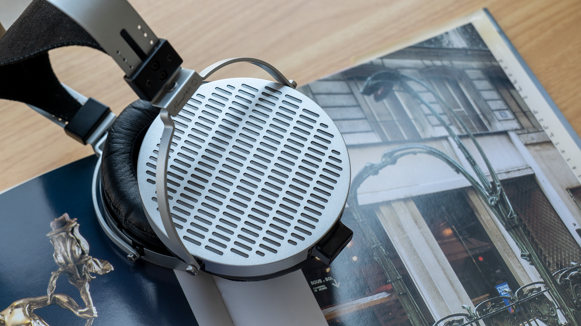

Readers with experience with Moondrop’s former planar magnetic designs like the Para and Venus will likely not be surprised when met with the Cosmo, as it has a very similar all-metal construction with round leather earpads and a suspension strap.
As far as the visual design language is concerned, I preferred the “art deco” earcup visuals of the Venus over the other two, but Cosmo isn’t bad looking by any stretch. It has a more “cheese grater-y” look to the cups, but this is arguably more congruent with the rest of the design such that overall I’d say it looks fairly cohesive, if larger and blockier than I’d prefer.

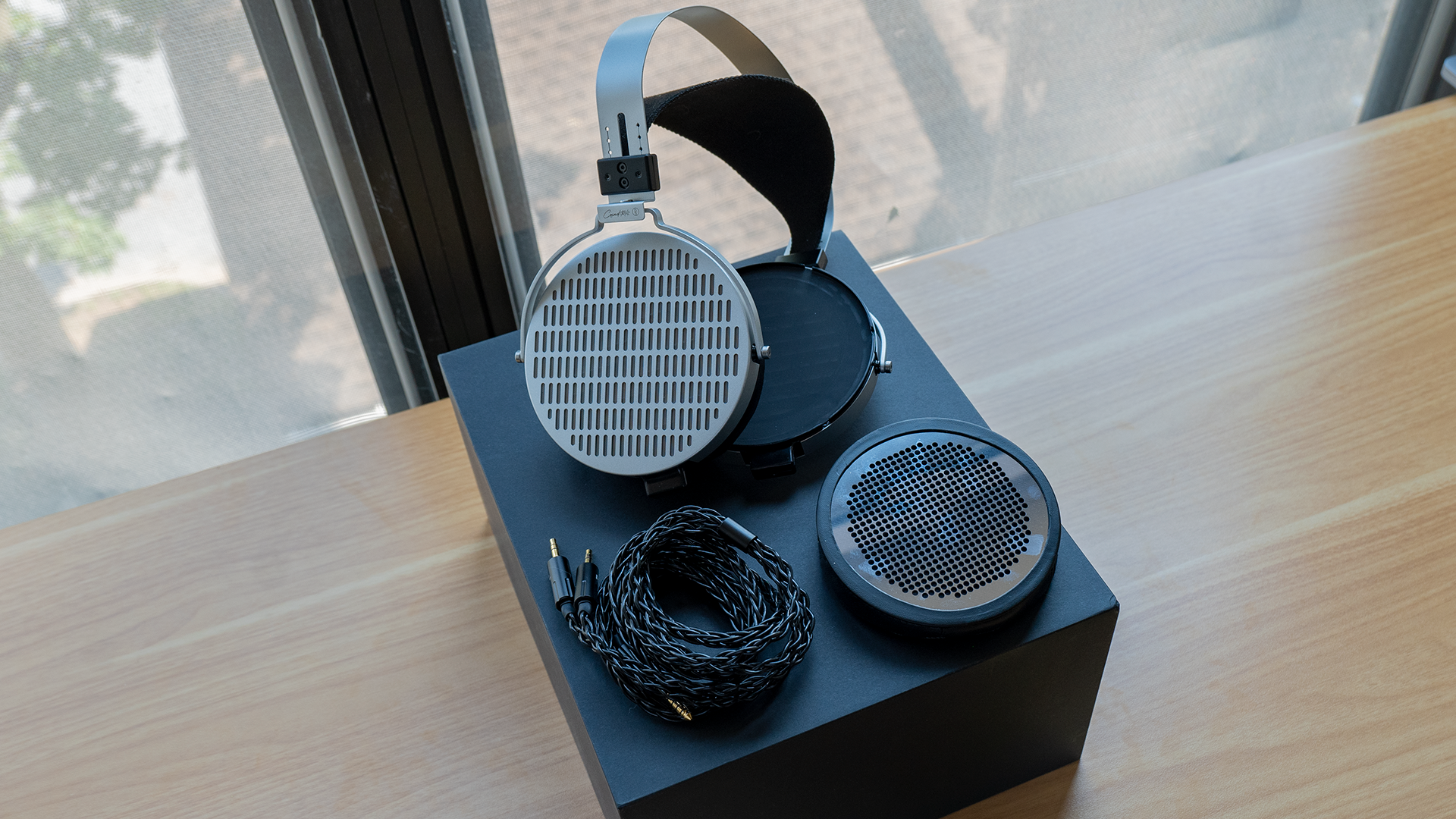

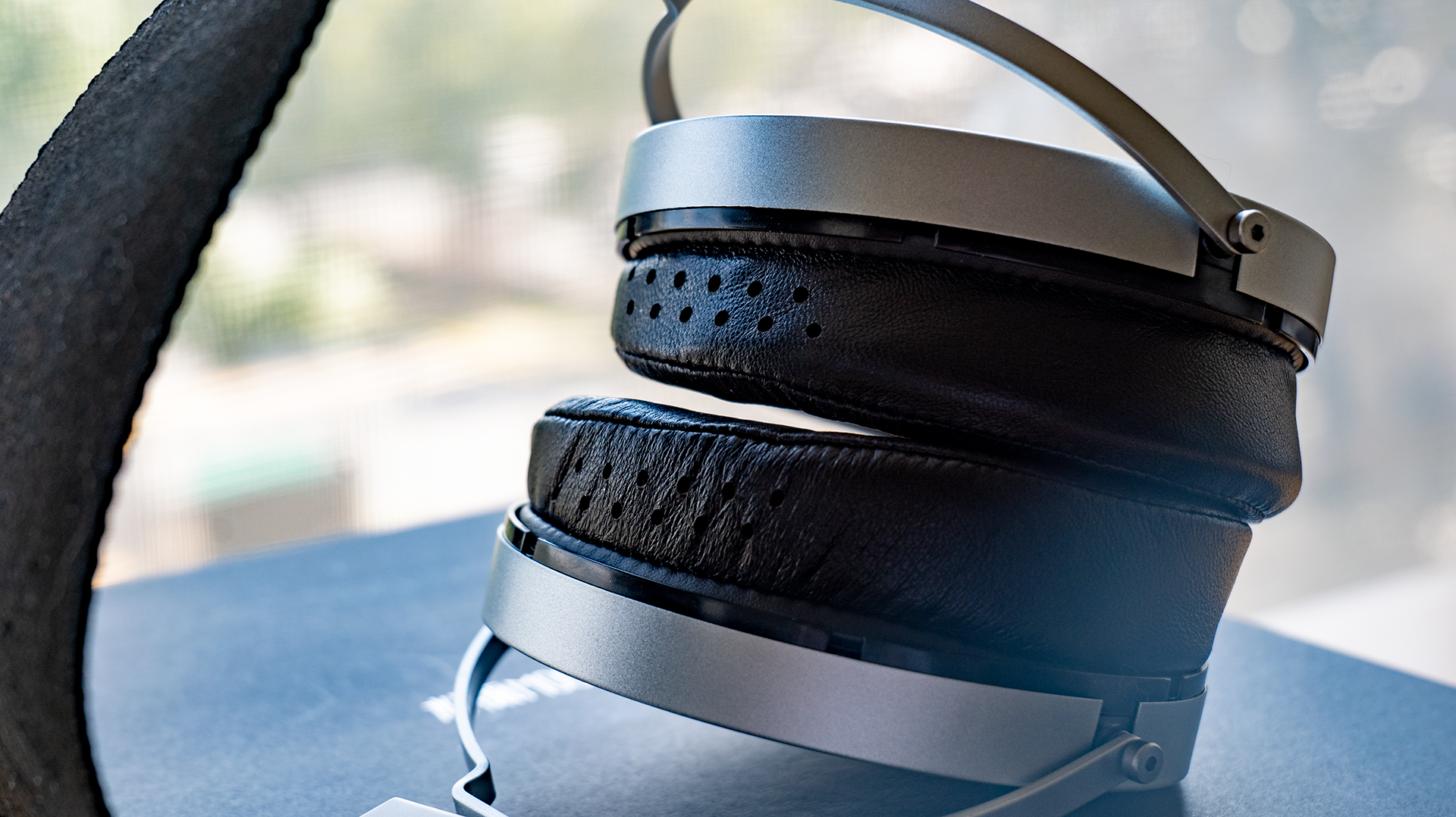

One thing I really like about the Cosmo is its ear pad retention design. It uses a removable magnetic metal grill that you can place inside the ear pad that then gets affixed magnetically to the baffle, which guarantees seal but also relatively painless removal/replacement of pads if necessary. This is one of the uncontroversially great things about this design, and I wish more headphone manufacturers did this. Big thumbs up.

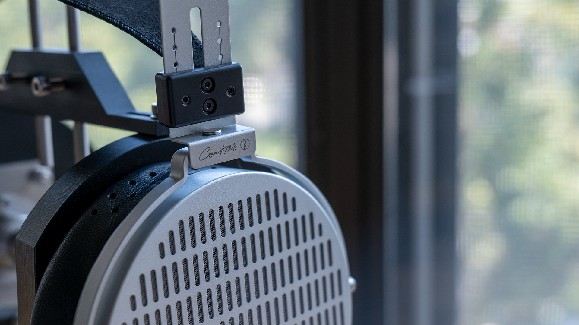

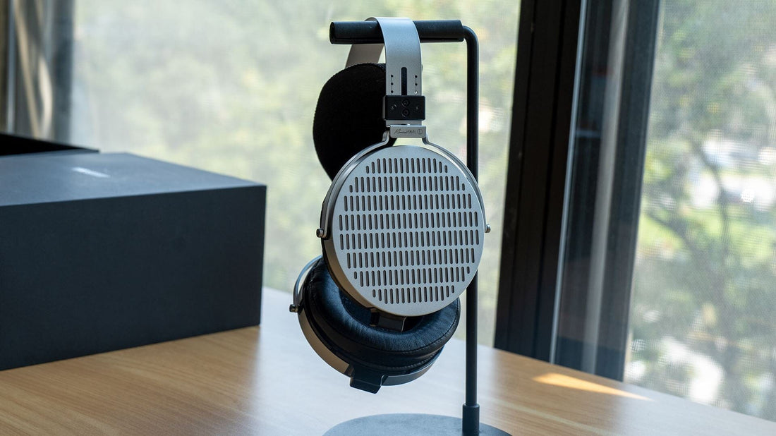

In terms of comfort, there were commonly-reported issues with this type of headband when it appeared on the Para and Venus, and Cosmo is plagued by similar issues. The headband extension mechanism is rather stiff but also inconsistent, which makes height adjustment a bit of a pain. I actually prefer the simpler strap of this headband vs. the padded strap of the Venus, though. I find the best thing a suspension strap can do is conform to the shape of the head with as much surface area as possible, and Cosmo’s strap actually does this rather well and I don’t get any discomfort on the top of my head.

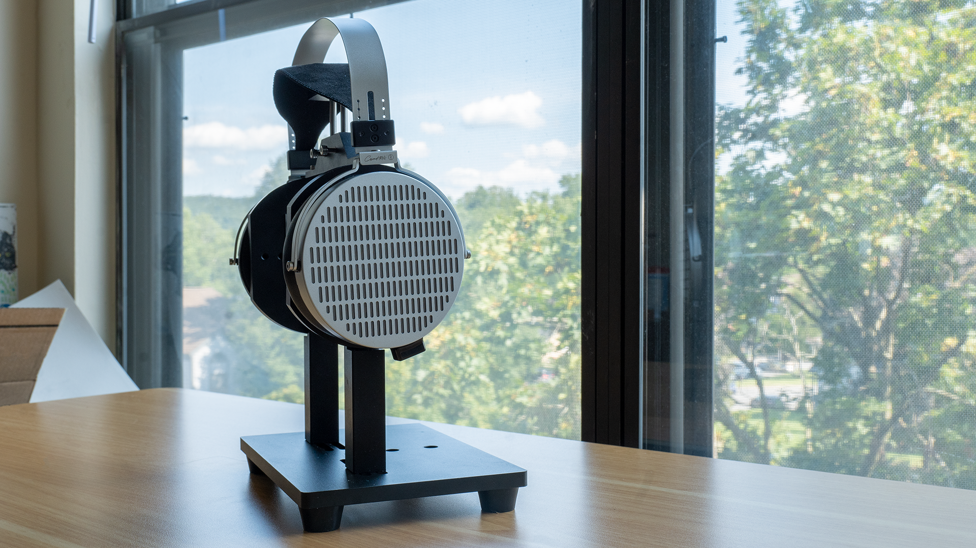

But the bigger issue has to do with the size of the headphone strap and the amount of extension: This headphone is seemingly made solely for people with massive heads, and is only barely usable on the smallest setting for me (where it still feels incredibly ill-fitting). To that point, I brought this headphone to a meet-up last month with a few audio friends, and among the 5 people there, none of them were able to wear the headphone comfortably on anything bigger than the smallest setting.
This hugely impedes comfort, as the headphone feels very unstable and cantankerous when used, making simple things like looking down or drinking from a glass without a straw damn near impossible to do without the headphone feeling like it’s going to fall off. This alone made using this headphone incredibly frustrating, and is enough for me to say that unless a reader has a very large head, Cosmo is something they should skip. If it were a sound issue, things like EQ or pad rolling could help soften the edges or make the experience more palatable… but you can’t EQ comfort.
In terms of build itself, the aforementioned headband adjustments feel a bit inconsistent in tension, such that I’m a bit worried that with time the “clicks” of the height adjustment will wear down and become basically useless. Many have already reported such a thing with the Venus and Para, so I’d advise people proceed with caution in that respect as well.

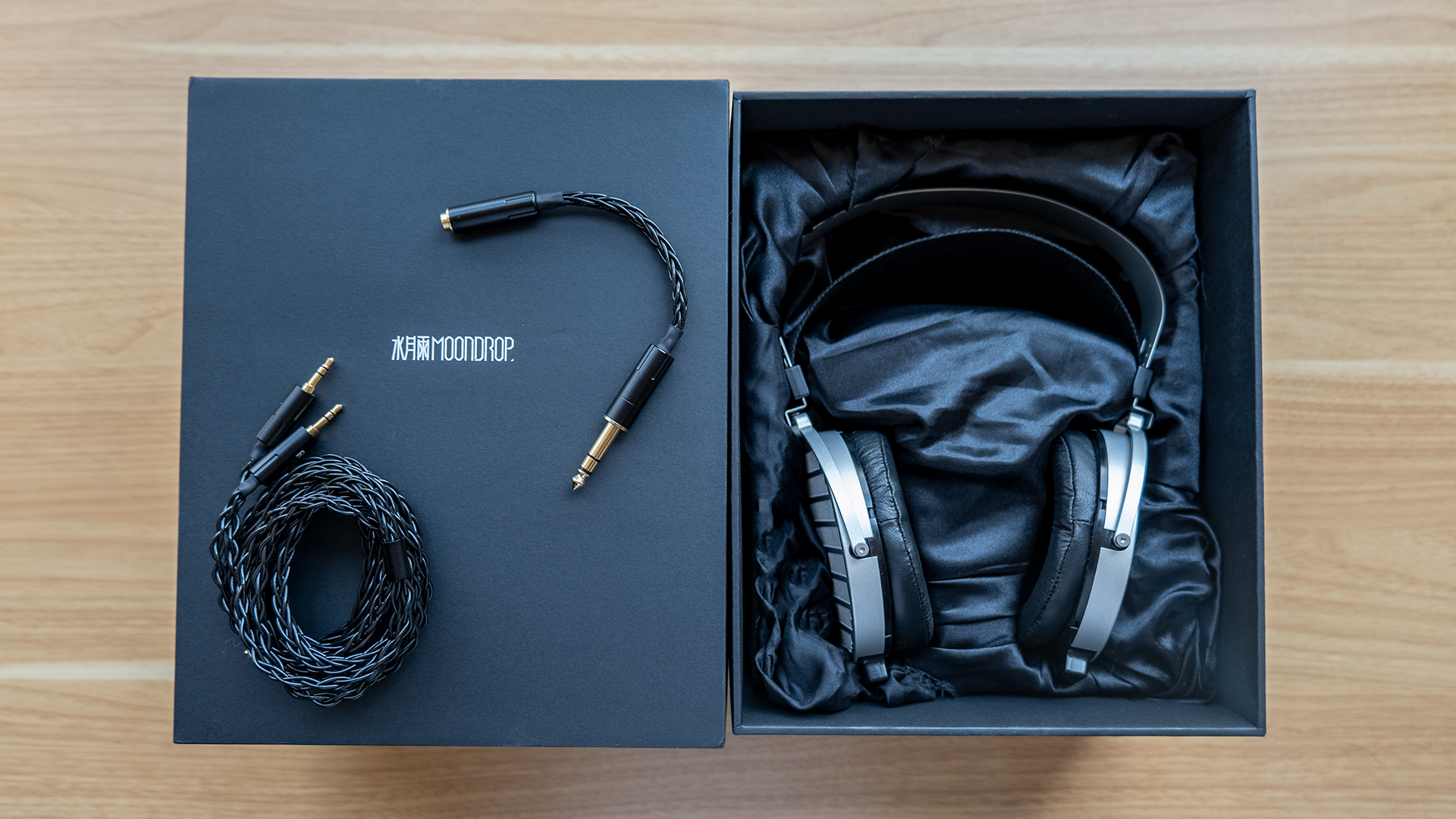

Lastly, the included accessories are a stock 4.4mm Pentaconn cable (terminated in dual 3.5mm TRS connectors on the headphone side), and a 4.4mm female to 6.3mm male TRS adapter. The cable is unfortunately fairly heavy and plasticky. It doesn’t have any issues with pliability, as its rather “soft” in terms of memory, and it’s not especially microphonic, but I immediately elected to use the Edition XS cable I’d had on hand just due to the added weight being a bit much and not having any 4.4mm sources I enjoy using.
Another note: I hate when the only cable a headphone comes with is 4.4mm Pentaconn. I get that this is a planar magnetic headphone, so the drive requirements and target audience means buyers are likely to have a 4.4mm source, but it’s always incredibly annoying to have to comb through my stuff to find something that has a 4.4mm input when I mostly use portable sources like the Qudelix 5k (which only has 2.5mm balanced and 3.5mm stereo jacks).
Overall, Cosmo looks pretty good, but the ergonomics are bad, the build inspires little confidence, and the included accessories aren’t very good either. Not a great start.

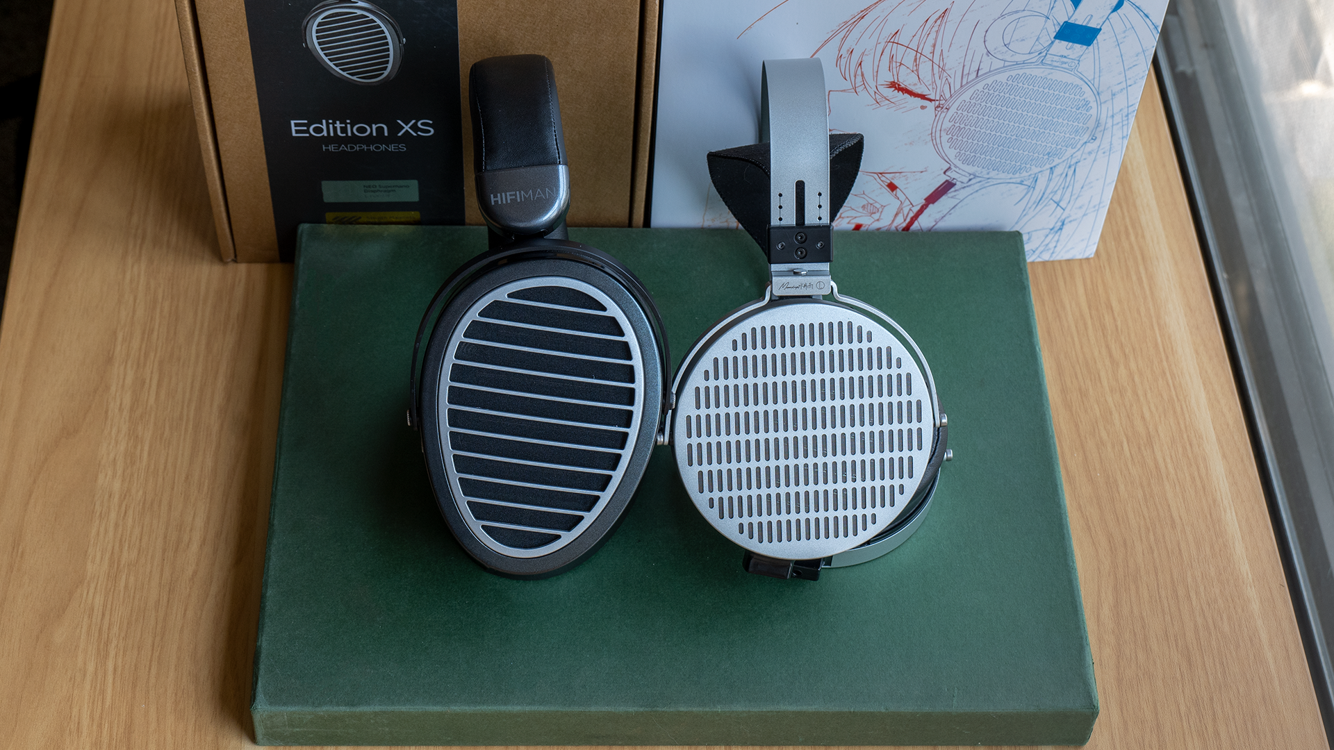

Comparison to Hifiman Edition XS
The Edition XS has a pretty big leg up on Cosmo for comfort and accessories, because it fits on my head and has a much better feeling cable. However, it certainly isn’t winning any awards for comfort on its own, as the headband that Hifiman uses for Edition XS is among my least favorite headbands that exist on today’s market. Its padding is stiff, and it doesn’t conform at all to the shape of the top of my head, so I get a pretty bad hot spot in the middle of my scalp almost immediately while using it.
That said, it’s still a more stable design than the Cosmo, and unlike Cosmo, users have the option to buy or print a Capra Strap that takes the Edition XS from a fairly uncomfortable headphone to one of the most comfortable headphones out there.
Sonically, I think the only thing I overwhelmingly prefer about the XS is that its bass is a much more noticeable contributor to the sound profile. From around 1 kHz down, it mostly conforms to a uniform downward tilt and has great sub-bass extension. So while it’s not a signature I’d call “bassy”, it’s definitely got more note weight and tonal warmth to its presentation, and that’s still something I feel Cosmo significantly lacks.
However, I think I prefer Cosmo everywhere else. Sure, the 1 kHz emphasis makes things sound a bit bass shy and vocalic, but overall the midrange sounds much more present, coherent, and visceral compared to the Edition XS’s “distant” presentation. By contrast, the typical-of-Hifiman 2 kHz dip causes the midrange and bass of Edition XS to be just a bit too warm for me.
Above this, the Edition XS has what to my ear sounds like too much of an elevation between 3-5 kHz, which highlights the breathiness of vocals and paperiness of snare drums too much for my taste. By contrast, Cosmo is much more reasonable and “HRTF-shaped” such that even if the overall upper midrange is a bit relaxed, I don’t get nearly the sense of “crash” or messiness from its upper midrange to lower treble transition here.
And lastly, the Edition XS has a bothersome elevation on my head around 11 kHz. Many headphones have an elevation in this region for me, but planar magnetic headphones—specifically Hifiman’s designs—tend to aggravate this region the most. Cosmo doesn’t have much of an elevation here at all, though. It has a little bit of an air spike above this (around 13 kHz for me), but overall Cosmo definitely isn’t a headphone I’d call bright or airy, especially not cloyingly so like the Edition XS is for me.
Edition XS is an amazing budget pick for a planar magnetic headphone, and at its current price it really makes a lot of Hifiman’s other offerings like the Arya lineup (which is generally even brighter) a lot harder to recommend. I’d happily recommend Edition XS to people—provided they get a Capra Strap and either know they want a brighter sound, or are game to try EQ.
But for a stock experience, I think the Cosmo sounds a lot more normal. Normal in a way that may be less exciting for some than Edition XS, but normal nonetheless. Unfortunately the comfort is just so poor that Edition XS wins by default, even if its the headphone I prefer significantly less sonically.
