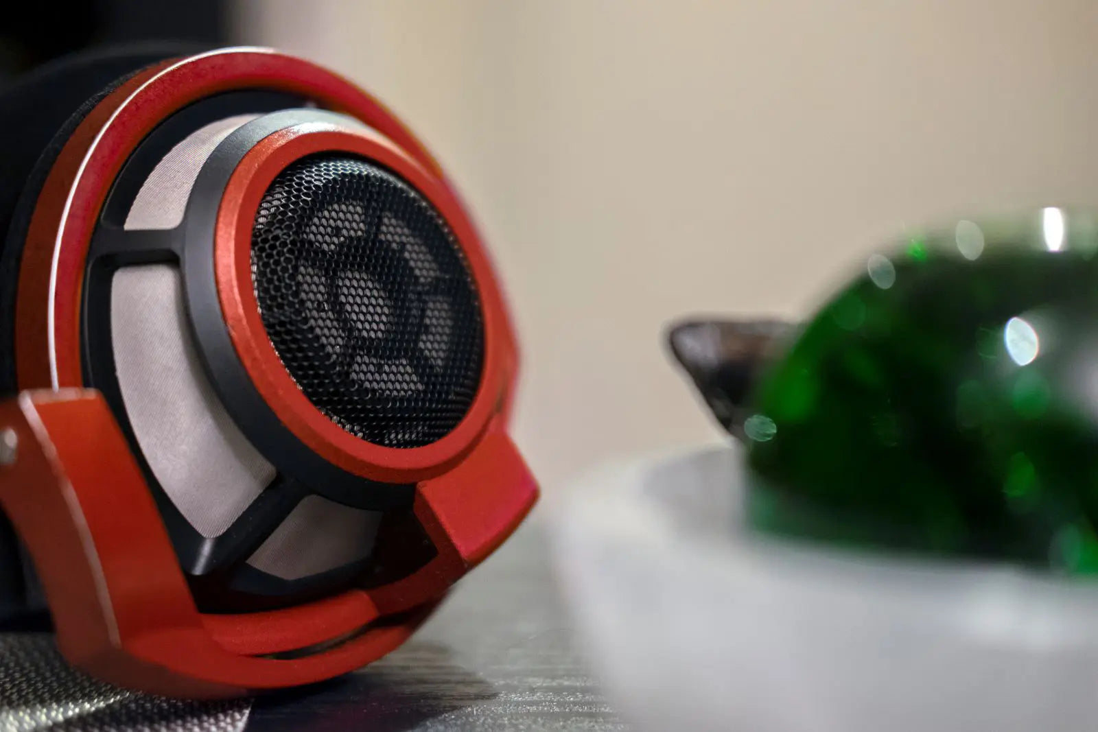

Sennheiser HD 800 and HD 800S
While the HD 600 is the king of midrange accuracy, the Sennheiser HD 800S is by contrast… not really the king of anything related to its tuning. It doesn’t have linear bass extension, it doesn’t have a very true-to-life midrange, and its treble is frankly pretty harsh and hard to enjoy in its stock formation.
But for all of its tonal faults, the HD 800S is probably the single best mixing headphone out there for use with EQ.
It’s a stunningly-built, professional-grade product, with some of the lowest unit variation in the entire headphone market, due to incredibly tight production tolerances. Its massively roomy earcups basically eliminate the problem of pinna (outer-ear) deformation, which can also change the sound dramatically from person-to-person.
To that point, the consistency of tonal response on different heads is also one of the best in the world, owing to its incredibly low acoustic output impedance (it reacts minimally to the “load” presented by the ear).
The HD 800S also has shockingly low harmonic distortion in the bass for an (extremely) open-backed dynamic driver headphone, and as such EQing the bass up for full linear extension—or even a bass shelf—is quite easy to do.
These factors together make HD 800S one of the few headphones out there where you really don’t have to worry that your EQ corrections may not be accurate based on someone else’s measurement of the same type (but not same unit) of headphone, as long as the measurement you’re using is done on an industry standard measurement rig and personalized by ear above 4-5kHz.
Anyone who has an HD 800S can (and probably should) find a publicly available EQ profile—like this measurement from our very own Resolve—and have the tonal character of a well-treated, good sounding speaker setup on your head basically whenever you want.
As far as caveats go for the HD 800S, it’s genuinely hard to think of many for this task. EQ solves basically every problem I have with the sound of it, and the build/comfort is among the best in the entire headphone market.
While HD 600 is best used for acoustic music, if you’re EQing an HD 800S you can use it for any music. It’s the most versatile option on this list once EQ is a factor, and it’s the one I choose to use every time I open up Logic Pro X and work on music because it combines all of these sonic aspects with a build and comfort that is even better than the already quite good comfort of its sister HD 6x0 series.
